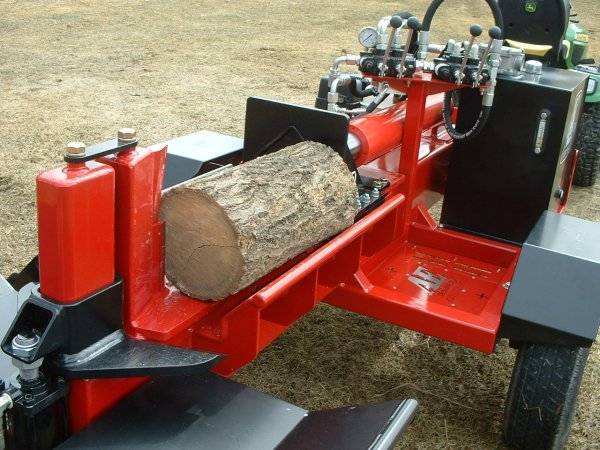

    People think a 4 way wedge is the ultimate. Then try and put one on a splitter that is made to be a conventional 2 way splitter.
    I am on my 2nd splitter that was made to be a 4 way. It MUST be hydraulically adjustable and the wing needs to be lowered enough so it can still act as a conventional 2 way on hard to split wood.
    Surprisingly enough, I don't use the 4 way a good part of the time due to how I want the wood to turn out. I prefer splitting into boards rather than pie shaped pieces.

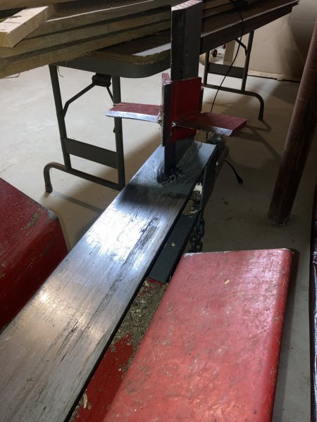

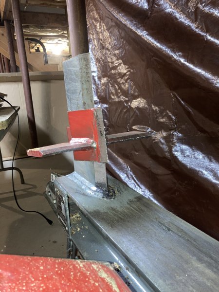

    This is the one a friend of ours made. My splitter is a 22 ton huskee it’s handled everything I have used it for. The only thing I’ve seen is I can’t have the pieces right against the beam because it spreads it out and binds everything up. Once I figured that out everything has been good. 2F6503CF-238D-40AD-A294-AB2D80AD4B72.jpeg DF123A22-AF17-4711-94AF-E714F8B6F4AE.jpeg EEE039AC-00AD-4248-BD70-1AEFB8480111.jpeg

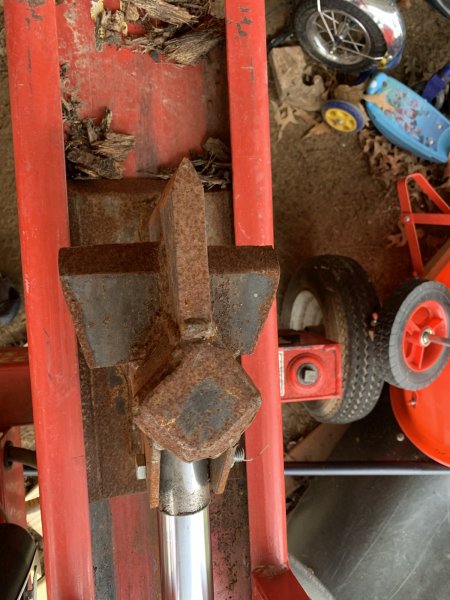

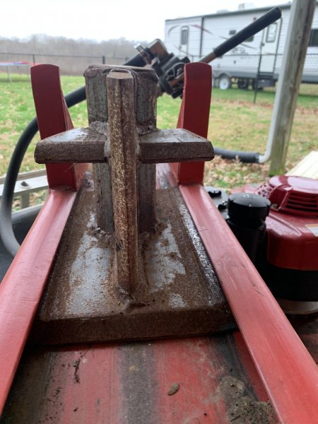

    Great topic. And hope this isn’t a total derail
    I’ve got a slip on the TW-1. They don’t advertise tons or mention it, but i think it’s comparable to 21.
    I like having it for the right wood and size. And I love having that wood and size. And having a lot lined up so I’m not constantly slipping it on and off.
    For that it’s great.
    For all others, it sits aside. It’s not worth slipping it on for the one off in the middle of knotty or crotch rounds

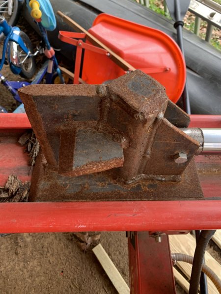

    Thanks for posting your pics! I couldn’t find any of my TW-1, and yours shows what I wanted to mention: this wedge can be flipped for different heights. I always use it in the opposite orientation, which allows me to to split smaller pieces in half, going under the wings, rather than quartering them.
    I use the 4-way for about half my rounds, but not for the larger stuff.
    The online info says the TW-1 is 19 ton, whatever that really means.
