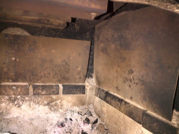

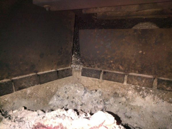

    Thanks S&W but I'm curious about the interior of the stove. My back corners and inside the interior shields accumulate a lot of build up, just curious if you get that also, as hard as you run the stove. I know Jeff and I see similar build-ups-(mine are worse), wondering if you're able to burn it cleaner, that's all. Thanks, JB.

    This is what it looks like this morning after 5 seasons and about 40 cord through it since its one and only cleaning when I bought it used in 09. It is definitely ready for a good overhaul/paint job this off season.
    I see a little gunk in the corners that I usually don't see...pretty sure it is from my wife finding the Oak I had set aside in the garage to give another year while I was gone this week.:headbang:

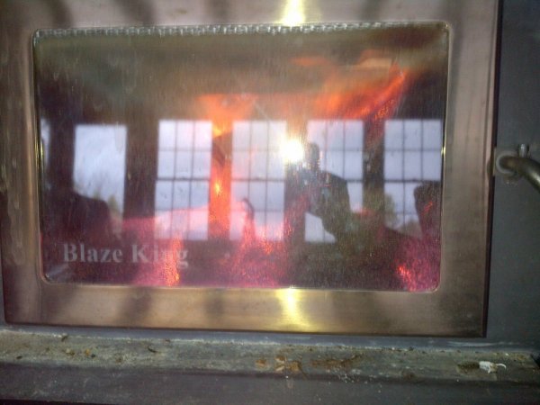

    Here is the glass shot...a little hard to make out the gunk because of the light through the windows but you get the idea

    That's way cleaner than my stove. I want to see how much junk you dig out from behind those shields.

    Much cleaner than mine also. Doesn't even look like much buildup behind the shields. Impressive.

    Where do you guys think the build up is coming from? One thing I do that may help is letting the house cool off a bit during shoulder season when I know I will be burning low and long. Then, bring the house back up at the beginning of the cycle with an hour or so solid burn before going low.

    I think it's just the smoke swirling around in the relatively cool firebox. At a low setting and with the blowers off, I can easily have 600° over the cat, and still hold my hand on the side shields.
    I'm not in control of the stove much of the time, so I'm not exactly sure what she does.
    I think it's funny that I have more creosote buildup in the stove than the chimney.

    That's one of the problems with shoulder burns.
    Not hot enough fires to burn off the creo.
    Another reason a BK is not the stove for southern locations
    where mild winters are " the norm "
    I'm still burning in the low smolder mode.
    Should be able to shut down soon for the season.
    Definitely gonna check/inspect/clean it this summer.
    I burn pretty hot normally, but this year was a relatively mild burn season.
