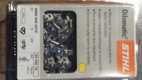

    Well they didn't have the 7 pin rim so I ordered it. I did pick this up though. Hopefully it's a nice upgrade from the current RS chain.

    I may be interested depending on the price. Any idea what they cost?

    RM will cut slower than RS but hold up better in Dirty wood. I have a couple loops of it around myself.

    I can find out my exact cost for you.
