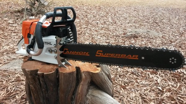

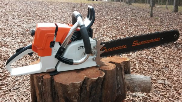

  13. Kg461
    Kg461
    Aug 2, 2014
    652
    1,023
    Provencal, La.
    Got the Cannon 22" Superbar in and a Oregon CK semi skip square chisel. Will try to make some cuts this week
  14. prell 73
    prell 73
    Dec 5, 2014
    1,961
    3,725
    ia
    :dex:damm that's a sweet saw.
    Chvymn99 and Kg461 like this.
  15. Chvymn99
    21,638
    115,169
    That's Sweet! :dex:.... And one heck of a rockin' setup....:rootintootin:
    Kg461 likes this.
