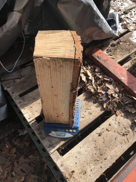

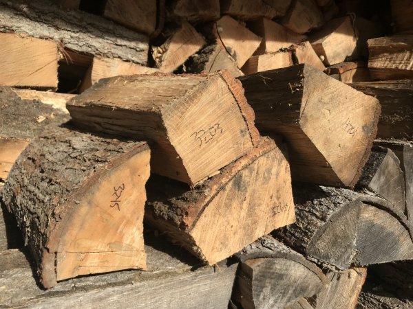

    I think a scale and a sharpie make a much easier way to figure out how much gets soaked in. I just weighed 4 pieces of 'red', that being 3 oak and one maple. Been stacked top covered since 2015.
    Its 25 now, going for a high of 33 today and then 43,48, and 56 over the next three days, all partly sunny. Mid afternoon RH of 42%, 61%, 61%,58%. 60 degree air can hold 4x the amount of water as 20 degree air so there will be a lot more moisture available for re-absorption as it warms up

    Results day one.
    Temps got to 51 today.
    The pieces of wood weigh in + or - one gram from yesterday. On 3000-4000 grams per piece that is insignificant.
    (A gram is 1/28th of an ounce. )
