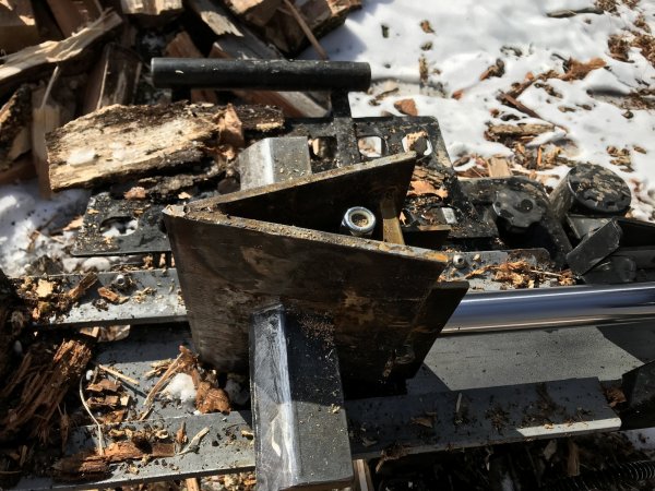

    Good point about the leverage factor! I'll have to stop by the shop where I bought it, they have a Split-Fire 3465(?). Which can be run with a 2-way or a 4-way. I'm curious to see what's different how the knife is different. The end blocks are wider & beefier. My machine, as is, is usually plenty fast enough when splitting by myself.

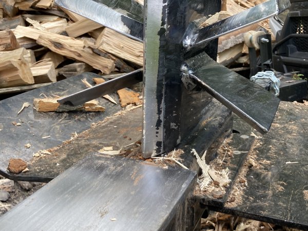

    Those wings are pretty long. I’d cut a good chunk off the ends. The wings are also pretty close to the primary wedge. A good ballpark is 1.5-2” of separation between splitting stages. That lets the wood open enough to drop the pressure back down before the nest set of wedges kick in.
    You have to know when to take the 4way off to break down a tougher piece of wood. I take mine off for the multi crotch pieces. Breaking down bigger rounds is a lot faster with the 4way. Either way you have chunks to handle, and the 4way makes those chunks smaller right from the start by removing that extra stick from the bottom. I can put a large round on the splitter and have it gone in 3-5 strokes.
    The advantage of a 4way is partially lost on a “wedge on ram” splitter because of the extra wood handling. A few people have tried to tell me that a 4way should not be on a push through splitter, but that’s where they shine. You only handle the re-splits and nothing else.
    We run 18-20” round through the 4 way without any trouble. It breaks them open better than the single wedge. Depending on how they crack open, we can either flop them off the wedge backwards (they land right where they need to be) or spin the halves around for the second go. It’s not much work and is more efficient than having to pick them up or throw splits out of the way all the time. Having a detent teturn frees up both arms for quick work. Two of us can split a full cord in 15-40 minutes depending on the species and size.

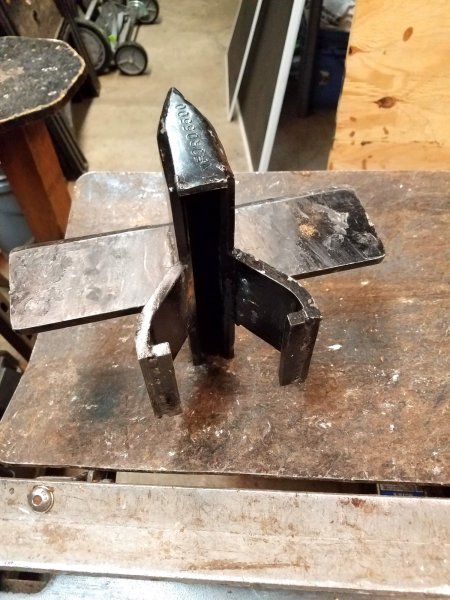

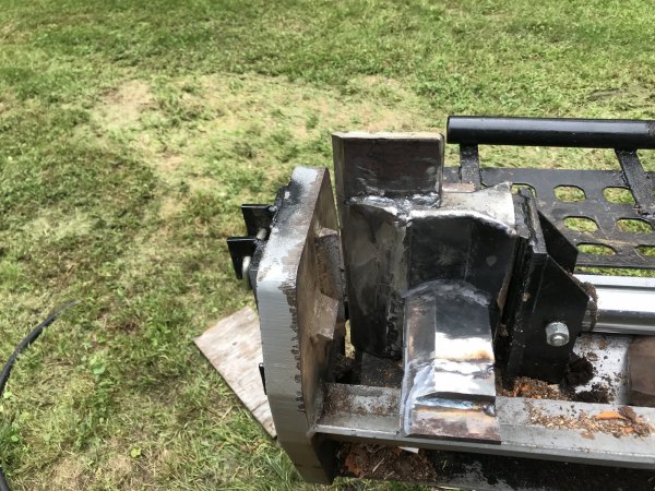

    Can’t speak for the 35 but my 28 DHT came with an entire seperate wedge system for the 4 way plus log strippers. Another single wedge came with the kit albeit a different design than the original. There was no V. It was a new shoe that accepted both a single and four way wedge that were allowed a little float. The inside contact point was in the front,,,,about 5/8” flat surface instead of a v shape. They were held in by a flush crosspin and the inner shoe had three seperate holes to adjust the height of the four way. There was no “back” as both slid over the shoe.
    The no back design is a weak point but not terrible in normal use. It was the stripper clips that did the most damage in reverse LOL. They weren’t manufactured to the full travel limits of the wedge if you had a piece of wood jammed under it. The open back allowed the strippers to bend the wedge forward,,,,,the opposite way it was designed to take abuse. Did a job on the strippers too.

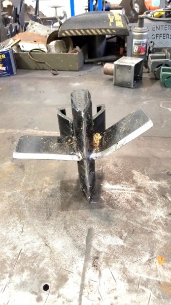

    This is the four way after I blew it apart several times and cobbled it back together with my superior welding skills. Added some thin cutters. A push thru doesn’t need them much but when the wedge is moving they’re required a bit more.
    It was fairly tough metal. Trying to bend it back with a 12lb sledge hammer was no fun. Ended up using the splitter as a horizontal press to squish it back in shape several times. The factory welds came done. The factory welds on the wings held up tho.

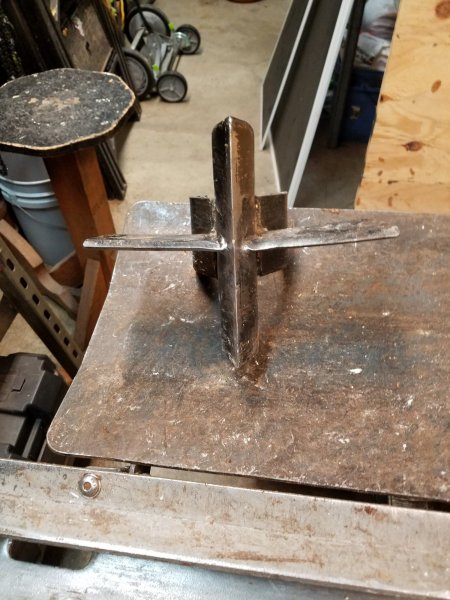

    One I made from metal scraps found around the homestead. Eventually killed it too.

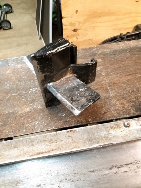

    Factory made six way for my new splitter. Anyone see the problem here? This was the most dangerous thing I’ve ever seen on a splitter. Dang near killed me a couple times until I sold it with a stern warning to the buyer not to use it in that fashion.

    That first wedge picture looks like a Klingon design! :eek: :)
  20. brenndatomu
    25,353
    165,137
    Well for starters the bottom wings have the bevel facing down...that seems bassakwards to me...that, and the thing is dull as a butter knife!
