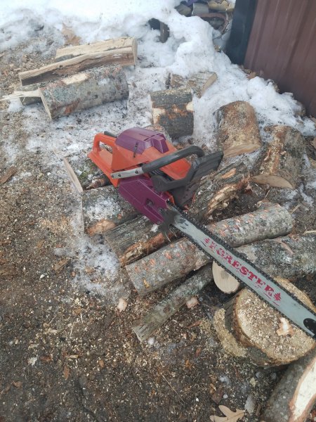

    Thanks to Kevin, Custer and Cole my 394 lives. Haven't had a chance to stretch it's legs yet. 20200223_080812.jpg 20200223_080759.jpg
