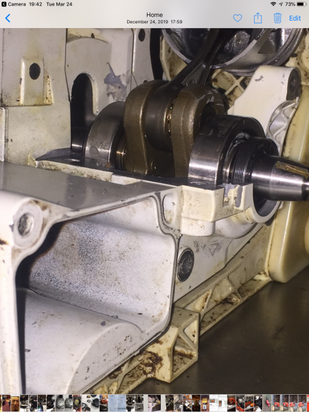

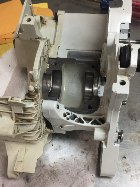

  15. M2theB
    M2theB
    Jan 13, 2017
    2,989
    19,074
    Central Massachusetts
    5F3E4859-079D-4C1B-8BD5-9824F95924A6.png You’ll have zoom in a little, but I think this shows it
