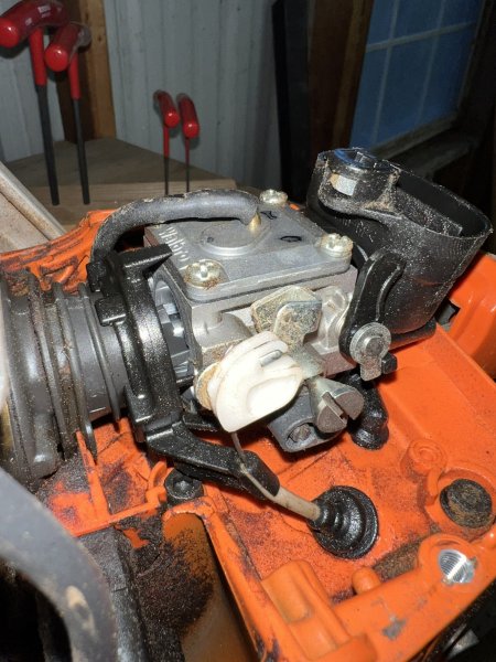

    So I finally got off my arse today and went and looked at my XT intake. It’s intact, so on to Walt’s method of tuning the carb. Here is a picture of the flap. 5532C78D-2A44-47A9-90FB-48B4B2A38655.jpeg

    Correction, it was Spike60 from another forum who wrote or responded to the thread on how to tune the L jet on an X-Torq carb. (Yes I have been searching for that thread since the 7th) In essence, a too rich low jet will puddle or pool up fuel in the intake boot. Lean the L jet out until you can tip the saw (after letting it idle for several seconds) forward without a bog or stall. Once you can do that you then adjust your idle speed with the idle screw.
