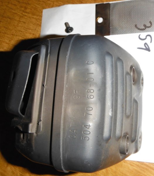

    Changed the cat muffler out last year
    OP:
    "Changed the cat muffler on my 359 after the warranty ran out.
    http://www.baileysonline.com/Chains...st/Husqvarna/Muffler-Assm-357-359-Non-Epa.axd"
    Pictures are of the original catalytic muffler
    The one on the saw now is the factory non catalytic, same one that's on the 357xp
    Took the screen out of the one on the saw last night.
    So have made a few small modification steps already.

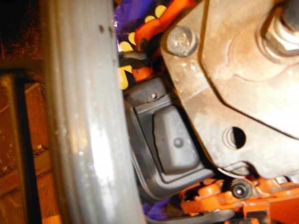

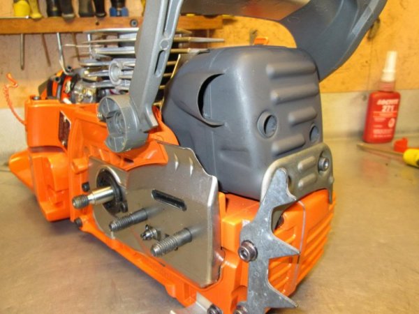

  17. bogydave
    Mm
    On the last picture, I don't see the top exhaust port, the original factory port.
    Did you hammer it flat or is the angle of the picture just not showing it.
    can see it here on my muff & the one on the saw.
    11379-70ef764326522b774bc8f8069717513c.jpg 11384-ce8f3dfed541e72606c8f9178a5aff52.jpg

    They leave them in place usually so its a dual port for more exhaust flow.

  19. Mastermind
    Mastermind
    1,257
    5,594
    Tennessee
    That is a NOS 359 and the owner wanted it to stay pristine. We removed the top outlet completely so it would never discolor, or melt the top cover.
