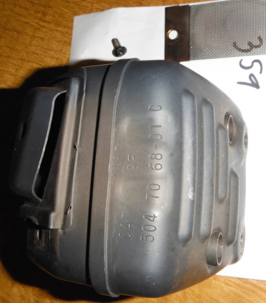

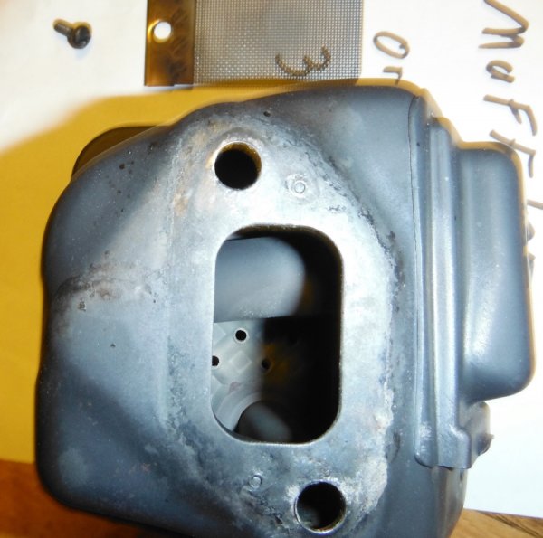

    Pics of the cat Muffler

  10. bogydave
    37,208
    If I pull the screen on the one on the saw
    Do I break screen off the metal tab & put the screw & tab back on?
    GRIZ likes this.

  12. DexterDay
    DexterDay Administrator
    12,411
    31,625
    Northeast Oh
    Remove screw and pull the entire screen out..

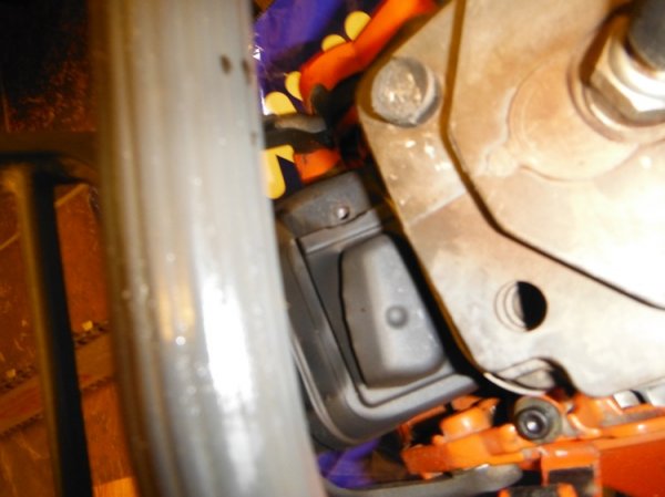

  15. bogydave
    37,208
    Pretty straight forward cutting rules.
    Nothing about the saw.
    Screen off, putting the tab & screw back in.
    Not sure hot gases are to go that direction under the plastic cover
    Will wait till tomorrow to run & adj.
    Dark, & 15° with 45 mph winds.

    The port in the muffler is where the exhausted exits the saw into the world. Some call that porting a muffler as there making the exhaust port larger. Porting a saw will increase the exhaust port diameter to allow the saw to ex spell gasses into the muffler easier. This will go along with an increase of the intake as well. Once you do this you also "port match the muffler intake hole and gasket to the newly widened exhaust port on the saw. Confused you yet. Its all just term I ology and who uses what how.
    We will call what you will be doing a muffler mod. And yes you possibly could do some good with a drill. But most likely will also need a dremel tool. You can probably drill out the internal baffled from the back of the muffler to allow the exhaust to flow through the baffel easier. Then you need to increase the hole on the outside of themuffler 2-3x its current size. This is where the dremel and carbide cutting bits or just a simple stine will help. Just start grinding away under the deflector. Prying it up with a screwdriver before you start to gain clearance for your tools. I have not had a 359 muffler in my hand so the process may vary a bit.

  18. Mastermind
    Mastermind
    1,241
    5,415
    Tennessee
    Here's how we do a 359 muffler.
    Cut a hole here, behind the baffle.
    Deburr it, and make relief cuts in the seam for the deflector.
    Make a deflector by cutting a 3/4" pipe on a sharp angle.
    Braze it on.
    And paint with high temp paint.
    PullinMyPoulan, Sunfish, GRIZ and 9 others like this.
