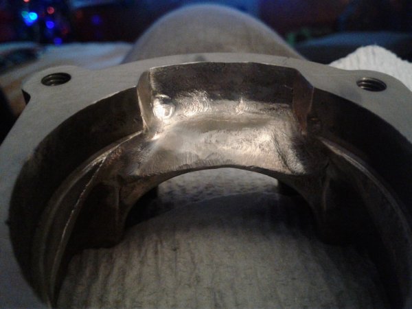

    I tore the saw down and the piston is done. The cylinder might be salvageable with enough work, but I am going to put my spare on it and not worry about it right now. The chains alone are worth what I paid for the saw. I don't need it, but you don't see a minty looking 350 every day. I already have a pile of saws, maybe 15 now, and most of them are in need of repair. The 350 needs a new drum, so I will convert it to rim drive. It also needs a metal intake boot clamp. I will sharpen the chains and dress what's left of the bar and see if it still passes for serviceable. If it's worn out, I have a brand new one on hand.
    I'll put new seals in it since they are almost 20 years old. I have to pull the cylinder base anyway to machine it, so seals are an easy add-on.

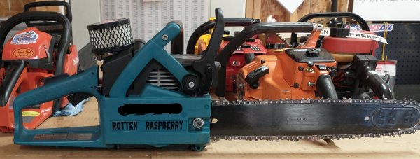

    My Makita DCS401 has a Remington roller tip bar on it in this picture.

    I missed a part of your question. A roller tip is just a smooth wheel on the tip with the same grove as the bar for the drivers to ride in. This in contrast to a sprocket tip, pretty much standard on most saws for years now, that has the teeth for the drivers to engage. I'm sure you are familiar with the latter. Lol

    Driller made some good saws. From what I understand, we both did the same stuff to the saw. It was strange to see jb weld in the lower transfers and it looked exactly like mine, right down the the air bubble in the same spot.

    You talking in the riser base? He showed me pics of when he did that. I ground out the dividers on mine and “smoothed” flow.
