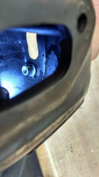

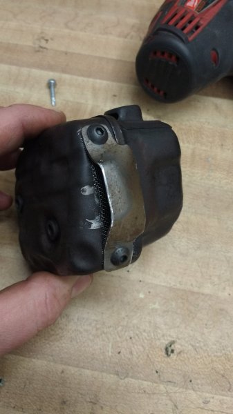

    final piece of the puzzle showed up today so in the next day or 2 i will finish this up.

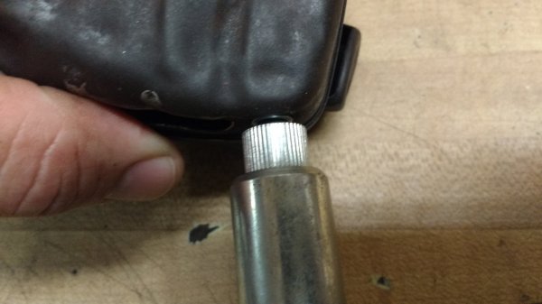

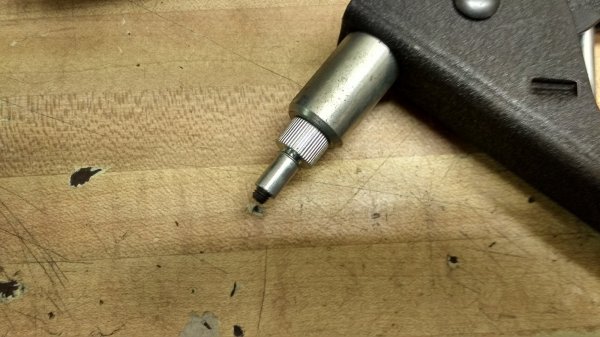

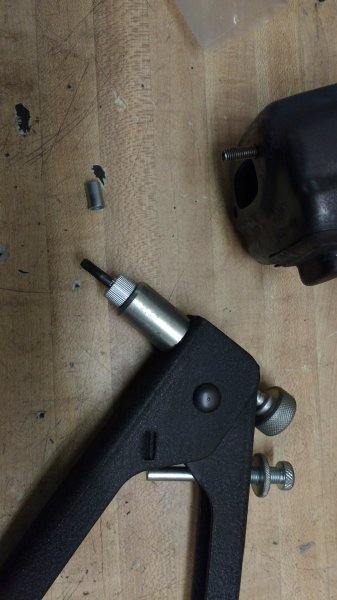

    Here is the nutsert tool and what they look like installed if you have never seen one.

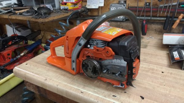

    Here is the finished product minus the brake flag. I forgot about it being broken and had to order one. Should be taking this thing out for a spin tomorrow after the flag shows up.

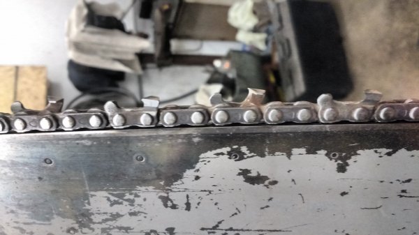

    That is a 20" .325 B&C in white pine that has been dead awhile.....my tree service is slacking on bringing me a new log to cut on. The saw feels plenty strong in the cut and the tach was reading between 10500 to 11500 in the last part of that video. Not bad for a 50cc saw even if it is rotten pine.

    my 346 came back in today for a checkup....new bar and chain on it....18" .325 .050 with Carlton K1C on it. bar buried in a maple log with light pressure it is holding 12200, bar buried with spikes set and moderate pressure is 11000.
