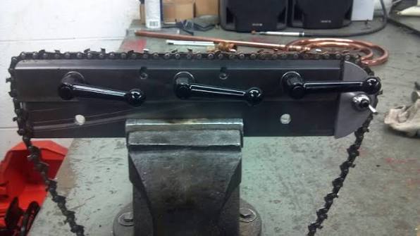

    I used to field file. Now mostly in a vise since I got the fancy chain vise to put in a...vise. I'll wait for 2-3 needing done and knock them all out at once. Not needing to have them mounted to a saw changed things for the better. The vise tool is just a simulated bar section essentially. Now I will generally only touch chains if I have to when out & about. Somehow, back when I had no idea what I was doing, I could pull off some great sharpenings on tailgates or in the dirt. I knew almost nothing. When I put them in the wood they'd just go. My two buddies ended up selling their MS311's that they bought because my 350 Hooskie was outrunning them in the cut. I didn't think a whole lot of those saws but I'm guessing that sharpening had a lot to do with the speed of my cuts vs theirs. They let the saw shop tell them what they wanted instead of just figuring it out ahead of time. "Firewood" saws.

    Interesting. I often file in my vise but its just a normal harbor freight vise. What setup are you using?

    Mike's Chain Vise. Only place/way I know to get them is to PM Homelite410 on OPEforum. He literally makes them. Mine is similar to this one. One of the best tools I have ever bought. I think I paid $120. Might be a little more these days.

    I need to get/make one of those. I never did like filing a chain right on the saw. The idea of having a small pile of tiny metal filings coating the chain you just sharpened, and sending that into the cut always made me cringe.
