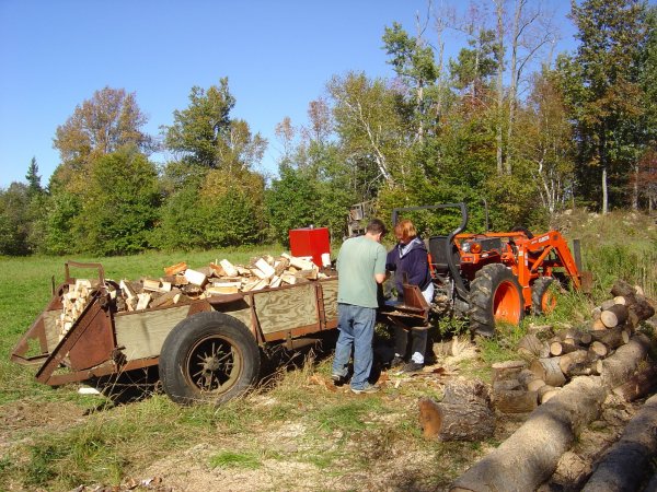

    I found an old picture of our old homemade woodsplitter set-up. This is a far better view of some others I have posted on here, and people can see how it was set up. It really worked well because it was a:
    Cut a tankful of gas in rounds
    Split those rounds and toss them into the trailer (old manure spreader)
    Haul to the house
    Stack, off loading the trailer by cranking back the live bed via the lever:
    sort of thing.
    It worked well because while work was always being performed, splitting was a break from cutting rounds, driving tractor was a break from splitting, and returning to the pile of wood was a break from stacking, etc.
    Note: this is my first wife Tina splitting the wood and not Katie.
