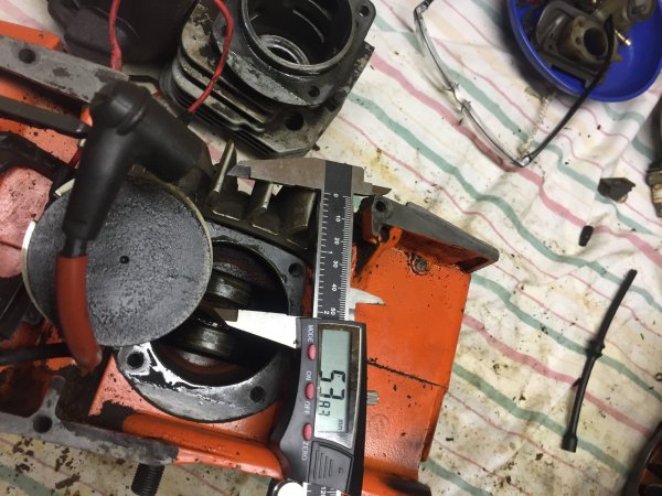

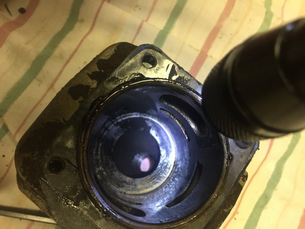

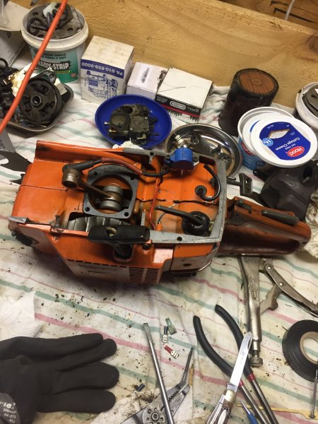

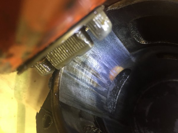

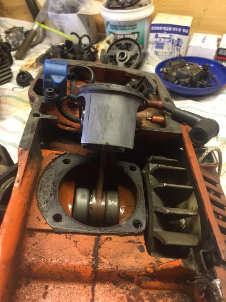

    This from the 160 psi machine IMG_6913.JPG it's pretty sludgey/dirty IMG_6914.JPG the curtains match drapes, cylinder has some good wipe. IMG_6915.JPG this is on the 140 psi machine. Looks a lot better than the 160. IMG_6918.JPG Swapped piston and cylinders from 140 to 160. Got marginally better. I'll throw the handle back on and try it again. Kinda awkward pulling it over just holding cylinder head. IMG_6919.JPG Checked squish to see what there for margin. Not much. IMG_6921.JPG The lower compression seemed to follow the p/c. Even though it looks a lot better than the higher compression machine.
    The 160 cylinder has a skirt that fits in the case and doesn't have a decomp valve. Those may be big pluses.
    Maybe a new base gasket and a Caber ring.

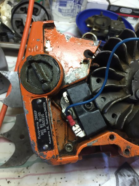

    Reconductored and re connectored the one machine IMG_6926.JPG the 99 is the one I'm going to focus on. It's cleaner inside and out and hopefully will be a runner with out a complete exploded tear down. IMG_6927.JPG Waiting on parts to build it and try a start. IMG_6928.JPG The other 288xp will be a complete tear down.
    I hope.

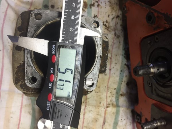

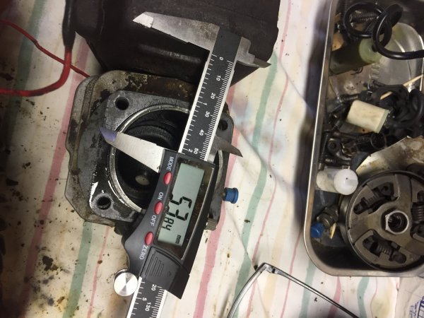

    Learned this morning that really what's on the bench is a 281 on a 288 chasis and 288 on a 288.
    I bought caber rings for a 288, comes two in a pack and they are for a 54mm.
    I did some measures and there was a difference. I learned that the 281 is a 52mm and is basically the same saw as the 288 except a smaller p/c.
