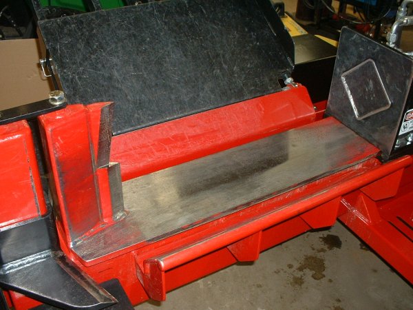

    I agree a sharp wedge helps a lot. BTW look at the paint worn off the wedge and you can truly see what part of the wedge is actually doing the work.

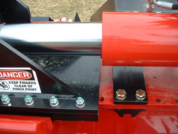

    Tonnage and cycle times are directly related, but one factor not consider so far is the length of the stroke. My splitter has an adjustable stop plate where it can be set anywhere between 19" and 30". I normally have it to accept a 23" round.

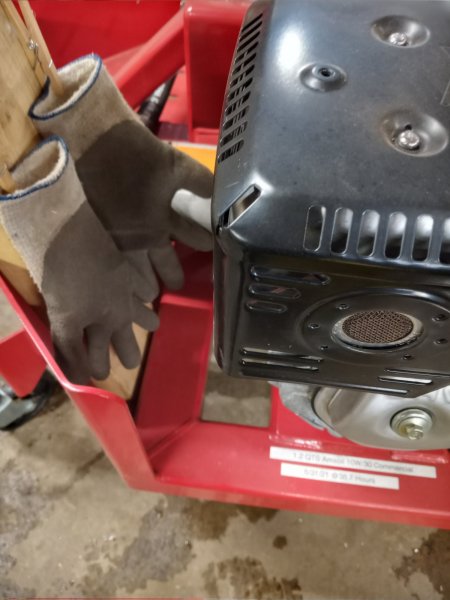

    The last pic is the optional glove dryer. DSCF0010.JPG DSCF0020.JPG 20220101_132002.jpg

    I like that stop idea. I usually cut my wood at 20" or sometimes a little over, so the 25" stroke on my splitter works out well without a lot of wasted movement and gives me just enough wiggle room. But if I were splitting shorter rounds consistently, I'd steal that idea! And the glove dryer is pretty neat too! :thumbs:

    That wedge looks awesome
