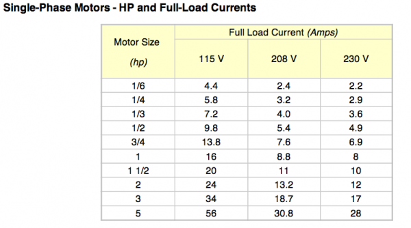

    That would be more like 4 HP then...the "5 hp" air compressor special that I started out with was overrated at 5hp, FLA on it is 16, so its barely 4 hp.
    I have another motor that I don't have installed yet, its 20 FLA, so true 5 HP...I'll be able to jack my pressures back up, not that it is really needed, 99% of the time.

    Here is a chart of motor hp and amps at different voltages. Newer motors are supposed to be more efficient than older ones.

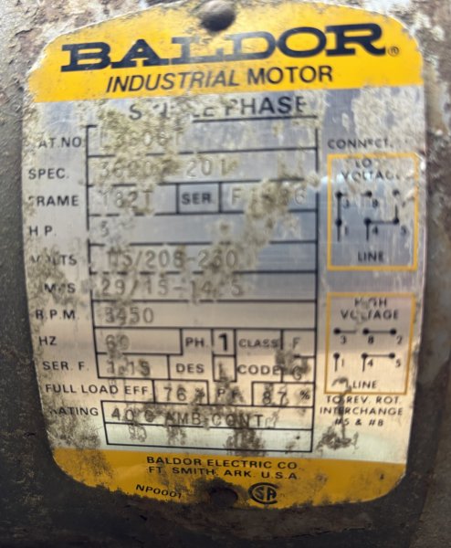

    I just checked mine and this is the plate. It is an old motor. I rescued it from the farm I grew up on as a kid. It powered the vacuum pump in the milk house for years and then sat unused for a long time as the roof fell in. The plate says it will use 15 amps at 208v and 14,5 amps at 230v. I am running it on 246v, so the amps should be 13.75. The service factor allows for about 16 amps max.
