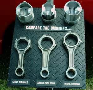

    Cummins, Dodge, everything will break EXCEPT the engine.
    chance04, eatonpcat, wildwest and 4 others like this.

    in answer to your original thought about a rod, if you break one of these you are in big trouble
    wildwest, Certified106 and Chvymn99 like this.
