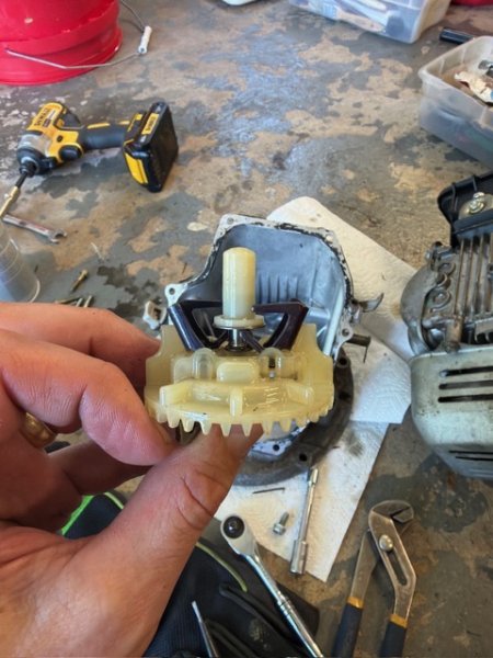

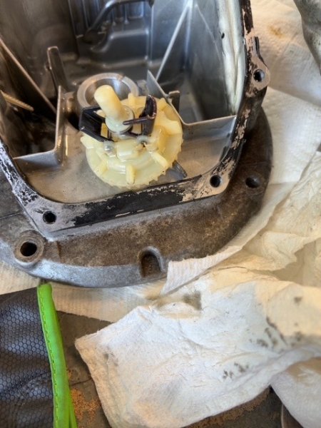

  13. Skier76
    Skier76
    Dec 27, 2014
    3,099
    17,123
    CT and SoVT
    I pulled the governor and unfortunately, no smoking gun. Everything was intact and moving freely. I gave it a good cleaning and no change.

    Long shot that hasn’t been mentioned yet I don’t think, but is there any chance that there’s a compromised wire(s) somewhere that could cause an issue?
  15. brenndatomu
    25,311
    164,784
    Once you unplug the on/off switch and the low oil switch, there isn't really any wiring left
    T.Jeff Veal and eatonpcat like this.
