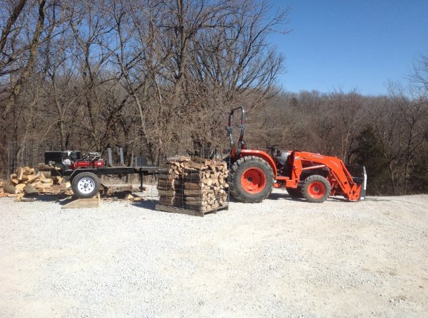

  16. Deacon
    Deacon
    Oct 9, 2014
    304
    1,615
    Eastern Nebr.
    My old 25 ton Huskee handled everything from easy straight grain ash to knotted gnarly twisted ugly Mulberry.
    Dennis is correct, two speed hydraulic pumps are the only way to fly. They "downshift " automatically & just power through.
    Personally I don't like splitting vertically so I wanted a log lift & table.
    Went from this ...
    To this...
    Working on some 2foot mulberry for the OWB today.
    Had to noodle some with my 660 mag first before I could even move em!
    css'd some standing dead red elm & ash earlier today.
    Good opportunity to use my trusty 028.
    I just wish they made them TALLER!!
    :sherlock:
