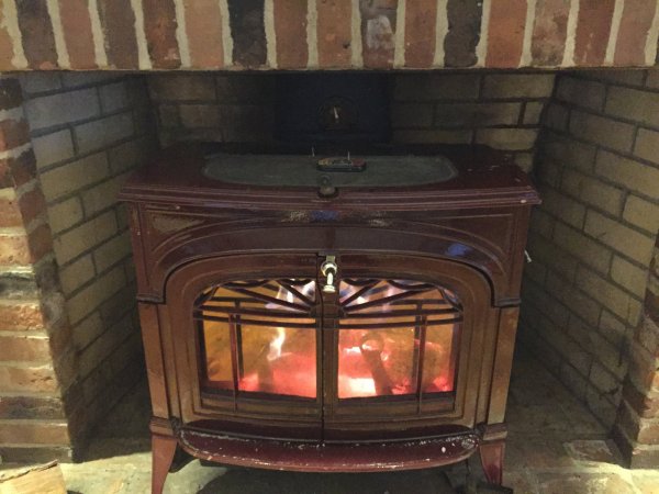

    Nothing crazy. Being that the Stove is in an actual fireplace I was able to utilize the old OAK that runs through the hearth into the basement to run all the wires, fan and cat probe (first year had it plugged into the outlet near the stove and it drove the wife crazy). I had put a thermo in the fireplace behind the stove and watched, without fan 120 degrees with fan 98 degrees and the room 68 w/o and 77 with!! I just position it as shown blowing across the back and bounce it off the firebrick into the living room.

    I just threw a fan behind the Defiant propped up on bricks so the fan is level with the stove top. Can't believe I didn't do that until now. Massive difference. It was heating well before, but the heat exchange at low temps really extends the burns.
    Not as pretty as a blower on a stove, but it works, and didn't cost me anything.

    My original plan was to mount this fan up near the block off plate but this is just easier.
