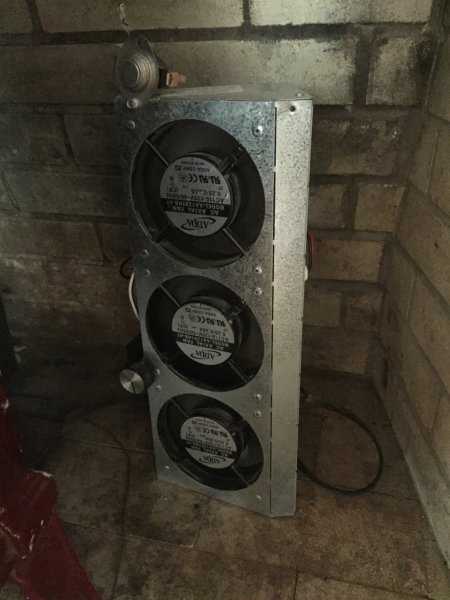

    Anyone try to hook up a blower to the Encore or the Defiant.
    If I can hook up a blower to the Defiant, I'd get a lot more heat exchange, which would help in terms of flexibility and extending burn times.

    I use this with the encore and it helps ALOT!! Looks like they have some new ones out too that looks like they would work better than mine

    Ooh that's a cool idea reckless... You just stand it back there and it circulates the air behind the stove? how loud? I might need to get one.

    the dial is adjustable so as loud as you want it hehe... on the lowest which still moves good air its drown out by the tv, maybe a little quieter than a box fan on low? The fan speed control and the thermo switch can be place anywhere you wish, I mounted them to the unit for simplicity and ease.
