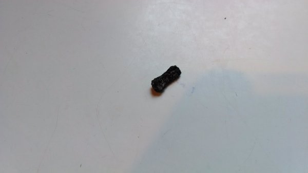

    Glad to hear you are having success. I had another scare last night (see the BS thread) with a near runaway due to debris holding the primary air door open. I managed to get it shut but have a nice welt on my hand for my trouble.
    Have to let it go cold now to get back there and clean it out... Id like to know whats getting in there as this is twice in two years and it makes me nervous.

    There really isn't anything down there...... Have you pulled the whole primary air assembly? What kind of debris?

    FWIW, I had found the gasket between the primary air frame and stove body was mis-shaped (or misaligned), causing the edge of the gasket to interfere with the hinges of the cast iron shutter. It would make the gravity-closed shutter hang open sometimes. I nibbled away the offending part of the gasket. Also, the rigid wire arm that connects between the bimetallic primary air coil and the control cable can get loose. The cheapo rivet (which attaches the rigid wire to the end of the bimetallic coil) loosens and the rigid wire can rub against the right air plate or outer body. If it rubs, that interferes with the smooth opening/closing of the gravity shutter for hotter/cooler bimetallic movements.

    This was the offender - a 3/8" chunk of old furnace cement.
    I felt around in there with my finger, still a lot of dirt/junk back there that I guess I did not get all cleaned out from the rebuild.
    Reckless-
    When I did my rebuild I didn't take the primary air frame off since the mechanism was in good working order and well adjusted. How hard is it to get back together and adjusted if I pull it now? I really down want to take the inside of the stove apart right now and I would be working pretty much blind back there since Im also not in the mood to pull the stove out of the fireplace mid winter.
    Maybe I can just use the tiny hose attachment for the shop vac and fish it in there.........

    Easy brother. Just those 2 screws and you should have enough slack from the primary wire to get it out. My paper gasket wasn't in great shape but good enough to keep a seal. Another idea would be to remove 1 or both inner walls and go down from that way as long as you have good attachments for the shop vac (I recommend the left wall).
    On second thought you could take out both walls remove the primary handle and then take off the frame. Adjustments are fairly easy just make sure to put the frame back on then the handle making sure it's working and holding (You have to really push on it from the inside when putting on the handle to activate the tension spring) then the wall. An hour job tops.
