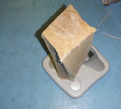

    17/18 wood:
  2. bogydave
    37,220
    How'd math go if it's 80% instead of 100& moisture content (per Fairbanks wood study of Fall cut birch) ?
    14.8/180 = .08222 ?
    9.2/.0822 = 111.92 /100 - - - = 11.92% ?
  3. Paul bunion
    Paul bunion
    3,397
    13,540
    Exactly. Your wood is done. It would follow that it should weigh 8.222 pounds when it is bone dry.

  8. bogydave
    37,220
    Another reason this one is drying faster.
    it's a center piece, no bark on the sides.

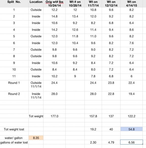

  9. bogydave
    37,220
    Weighed the wood again , lots lighter.
    today's numbers:
    Don't know what the %-atges are but has lost a lot of water weight (6-1/2 gallons of water).
    As expected , the inside stuff lost the most.
    #2, square split , all sides no bark seems to have don the best.
    Deacon, fox9988, Eric VW and 4 others like this.
  10. Backwoods Savage
    49,259
    314,652
    That tells a good story Dave. Especially when we see people cut and burn. This gives the picture of how much water they have to evaporate before they get useable heat from the wood.
    Eric VW, milleo and papadave like this.
  11. papadave
    Great info Dave.
    Nice chart, and easy enough, even I can understand it.:thumbs:

  12. Paul bunion
    Paul bunion
    3,397
    13,540
    Nice drying. At 80% initial, if that Fairbanks study that was dredged up is correct, your indoor splits average 7.4% and your outside splits are at 28%. Your square piece had to be wetter than 80% as it would be at zero today if it was 80.5 to begin with. And unless your wife kept it in the oven while you were away it would be kind of impossible for it to be at 0%. So going off the results of that piece it would seem reasonable to assume your initial moisture was more than 80%.

    226,206
    Bogy, I started reading this thread again and was hoping you put up a "progress chart"!
