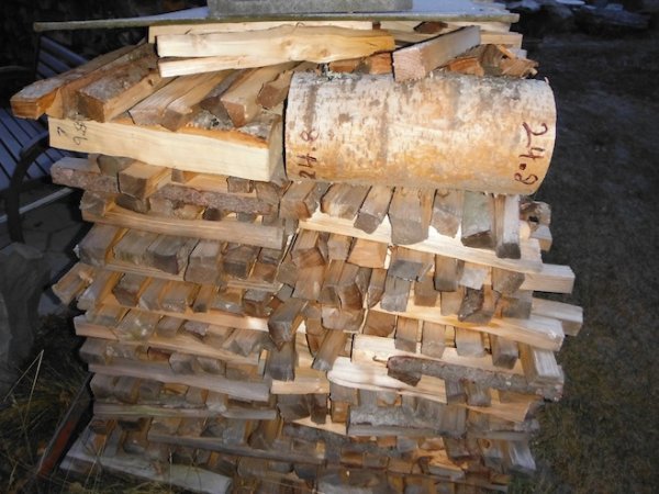

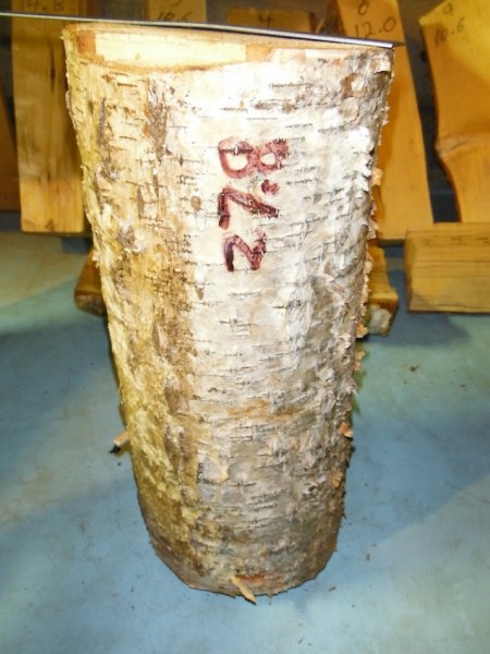

  3. bogydave
    Good idea :)
    OK
    Inside round is a 7-1/2" X 7-7/8" x 17 1/2 " round
    27.8 pounds
    Outside round is 7-1/4" x 7 -1/2" x 16-34"
    24.8 lbs
    Will arrange it better in the stack when done splitting . :)

    Nov 7 / 14
    Outside wood:
    1 - (12.2) now 10.8
    5 - (12.0) *** 11.0
    7 - (9.8) *** 9.0
    8 - (9.8) *** 9.2
    10 - (8.4) *** 8.0
    Round- ( 24.8) *** 24.4
    Inside wood:
    2 -(14.8) now 12.0
    3 - (10.6) ... 8.2
    4 (14.2)...11.4
    6 (12.0)...9.6
    9 (10.6) ...8.4
    11 (10.2)...7.8
    Round (27.8) ...28.0 (? weird )
    CSS 2013:
    1/2 split (10.0) ...Oct/14 (( 6.8 )) now 6.8
    Triangle split (8.4) ((6.0)) now 6.0
    Sq, bark 1 side (7.0) ((5.8)) now 5.8
    As expected , inside stuff is drying faster. but amazing how much weight in a few weeks.
    Outside stuff loosing weight too, been above freezing & windy, that's gotta help.
    2013 stuff kept inside a year, no change, about ready to say it's as dry as it will get.

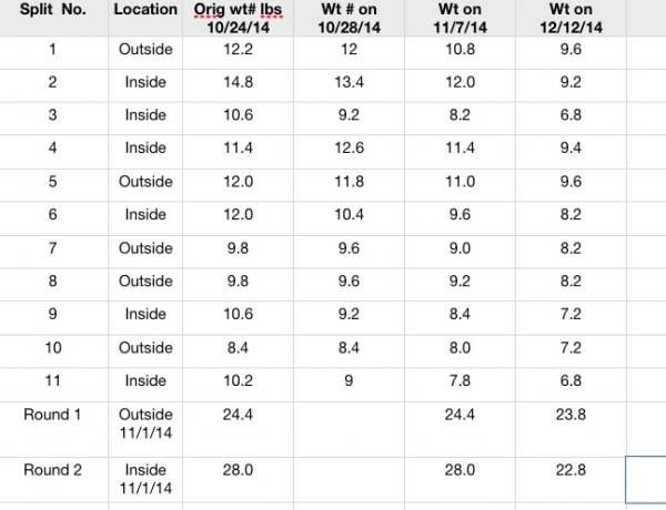

    Learning numbers.
    Clip art picture (not sure how to post a spreadsheet.)
    Using Numbers, (Mac spreadsheet)
    could plug in some formulas into the spreadsheet if you help with what & how ?
    Well Seasoned likes this.

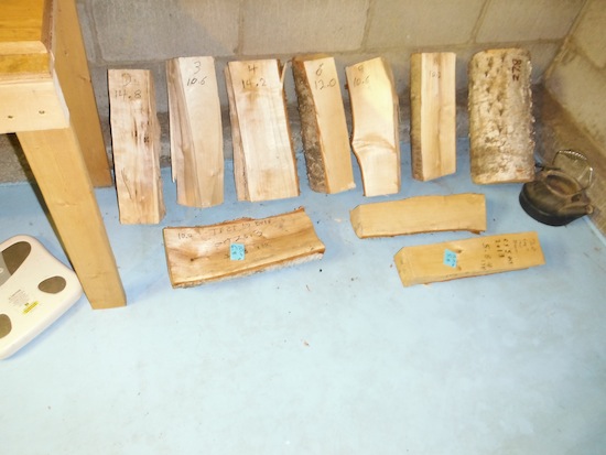

    35841-d910fe852596266f1dea02436d41bf14.jpg 34937-b6a70afcb8a08a24ed0c1596272452af.jpg
    Amazing , the inside ones, some lost over 5-1/2 lbs.

    Todays weights / List:
  14. Paul bunion
    Paul bunion
    3,383
    13,376
    Ready for the math?
    If piece #2 was at 100% moisture content then it at 24.33% today.
    14.8/200=.074 (200 comes from it being 100 parts wood and 100 parts water)
    9.2/.074=124.33 24.33 is your % moisture. (still 100 parts wood but only 24.33 parts water)
    See if it drys some more and we can figure if the 100% assumption is plausible. Looking at the other pieces that one showed the most drying.
