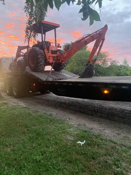

2005 Kubota L48. My next work partner!

    BTW.. Makes for a great sunrise pic.
