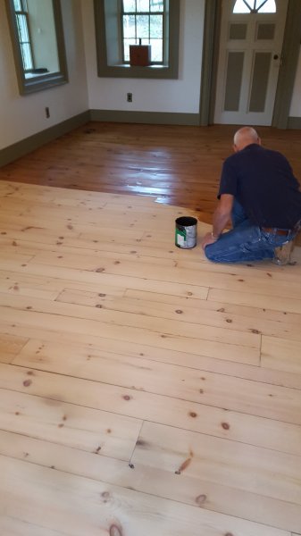

    We went wit resawn,reclaimed lumber for our flooring in our 1860's farm house. NOT cheap but got the look we wanted. These were old barn beams resawn and tongue and groove. I put several floor support posts in the basement for strength and it also helped with the creaking. Word of warning. If you have indoor pets pine is not the best due to it being soft.

    farmer steve, those deep windows are really nice. Post and beam house framing or are the windows bumped out a little?

    Brick farmhouse. We made them a little deeper than original when we put 2x4 studs in for adding insulation and giving us a place to run duct work upstairs. We used cabinet grade plywood for the sills, sides and top. My trim guy replicated all the trim to look original. We used old village paint for the older look.

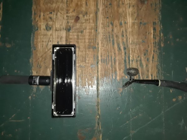

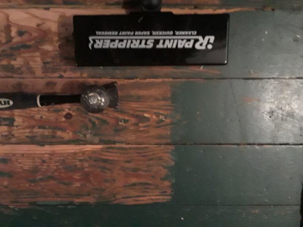

    So I didn't want to go with the stripper chemicals if I could avoid it and I didn't want to go with a heat gun due to the possible chemicals(lead) given off. I picked up a cheap heat gun to give it a shot and it does actually work pretty well.
    I found this thing called an infra-red paint stripper and it does a really good job. You put it on the floor for 30 seconds, move it to the next spot and then scrape off the hot paint. I think this will get most of the paint off to the point that I can use a sander, chemical stripper or heat gun to finish the job. This is probably a little slower than a heat gun but uses a lot less energy and only heats to 400° so it doesn't burn the paint, just gets it really hot.
    I have some seriously ugly floors and I am hopeful that I can save them. This green floor is one of the better floors in the house with only one or 2 coats of paint. I will be interested to see what happens on the rooms with 8 coats.

    Are there any health concerns with this if that is lead paint?
