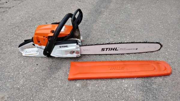

    This brings up two questions. Thoughts on this Stihl MS261 that was used once and is listed at $500?

  9. buZZsaw BRAD
    35,161
    217,730
    Great buy at $500. Is it a 261C? That model has an electronic controlled carb so no adjustments needed.

  10. Zack323
    Zack323
    Sep 18, 2022
    428
    2,480
    Douglas, WY
    The sticker doesn't specify nor the listing. I did notice 4 bolts and muffler look a little rusty in the photo. I'll try to look at it in person. Otherwise, I think I'm sold on the 20" Echo 4910.
  11. Zack323
    Zack323
    Sep 18, 2022
    428
    2,480
    Douglas, WY
    It does have the H/L adjustments marked on the head. Not sure if the C has that?
  12. buZZsaw BRAD
    35,161
    217,730
    On the pull rope cover it will say "261C" if mtronic
    Screwloose and T.Jeff Veal like this.
  13. buZZsaw BRAD
    35,161
    217,730
    Never really checked on mine. Ive owned both varieties of the 261 and a great saw. I paid $500 for my barely used 261c a year and a half ago. My go to saw for average cutting.
