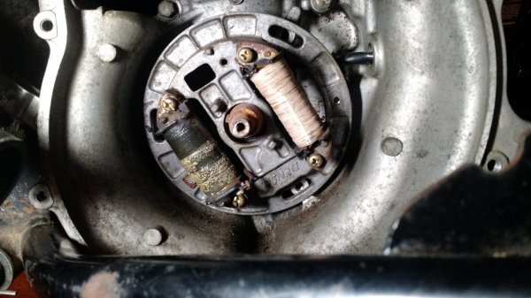

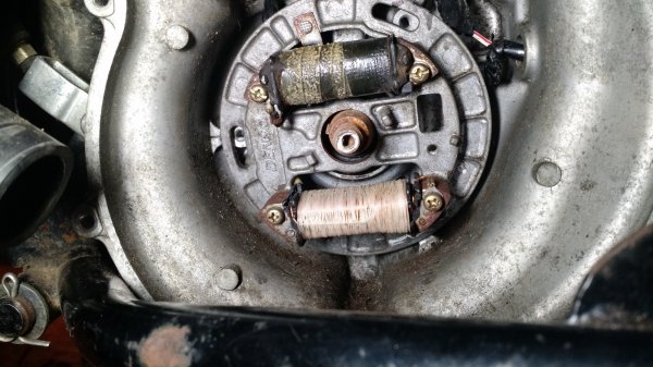

    Yup, I saw the case marking but on the stator the line wasn't as obvious, so I marked it before pulling it. Then I dug up the manual and inspected closer to see where the machine mark was.
    The design is not foolproof as indeed all 3 holes line up no matter what. Pretty poor engineering there.
    I will take a pic tomorrow. Dinner with in laws tonight prevented me from working on this more, so hopefully tomorrow I continue on this way too long project.

    Exhibit A, my sharpie marks added so I could remember the position it was in. Case marking is at 9 o'clock.
    And exhibit B is the correct alignment. The screw holes line up regardless.

    I hear ya, it's wicked hard to see. You can see the mark at 9 o'clock on the case? Go 2 minutes (or is it one minute forty five secs?) CCW, and it is faintly there on the stator to the outside of the screw hole. Furthermore, that's where the manual shows it which is why I knew where to look. Black windings were horizontal top/ white were bottom and the mark is there so I am fairly confident on this.
