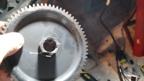

  8. cwn877
    cwn877
    1,174
    4,542
    Central Pa
    That looks like the starter gear that's on the opposite side of the motor behind the clutch assembly. It probably has some loctite on it and a little bit of heat can go a long way.

  9. cnice_37
    cnice_37
    3,212
    14,241
    Yup, been calling it flywheel knowing it wasn't. It is the starter gear, good call.

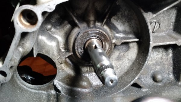

    IMG_20170220_111950842.jpg IMG_20170220_111950842.jpg IMG_20170220_111937718.jpg This took a while, but final solution was my dad's biggest dent puller with a fork tip, heat, and ultimately a cutting wheel.
    Sadly, the flywheel isn't even on this side, shows how little I know about this thing. :hair:. However, I am fairly certain I will need to get to the crank seals so all is not lost.

  14. cnice_37
    cnice_37
    3,212
    14,241
    Timing is off by 120 degrees. Someone has been in here before as it is missing one of the 3 screws that holds the stator in place. Not sure if 120 out will make it not fire at all, but makes sense to my simple brain.
    Hoping to pressure test it tonight if I can rig up something through the plug hole. I figure I am already staring at the seals, might as well test them while I'm here.

  17. brenndatomu
    25,292
    164,649
    Oh, I thought you were saying someone bolted the stator in 120* out...the more I think about that it probably isn't even possible.
    So the flywheel key was OK?
    Horkn likes this.
  18. cwn877
    cwn877
    1,174
    4,542
    Central Pa
    That's a possibility. I've learned that with some people anything is possible.
    cnice_37 and Horkn like this.
  19. cnice_37
    cnice_37
    3,212
    14,241
    Someone dumber than me indeed installed it that far out. Key on this side is intact. Shaft is one rusty dude.
    Horkn likes this.
  20. brenndatomu
    25,292
    164,649
    So you are saying the stator really was mounted 120* off?! I didn't think that could be done due to how the wiring goes through the case...not to mention I wouldn't think the screw holes would line up...but sounds like maybe that's why there was one left out! :headbang:
