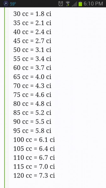

    Ya Mike Ill choose protection over performance for longevity!! Hey Mike can u explain what the 3,4,5 cube and so on means? I really dont have a clue. Thanks
  10. mdavlee
    mdavlee
    Oct 21, 2013
    4,380
    10,479
    Cubic inch size.
    3=50cc
    4=65
    5=81
    6=99

    So 3 cube is 50 to 64cc?
  12. mdavlee
    mdavlee
    Oct 21, 2013
    4,380
    10,479
    Yes but they have to be under for the race classes. They try to get the most cc they can into the class normally. 681 and 181/281 is the closest to 5 cube. 365 special is just under the 4 cube limit.

    So a 181 and a 660 r both 5 cube?

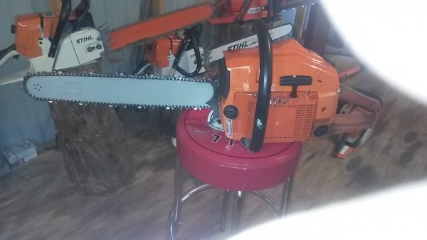

    20150509_134630.jpg Just finished this 181 the other day. Very strong running solid saw

    181 is. The 660 is over 81 cc so it has to go to a 6 cube class.
