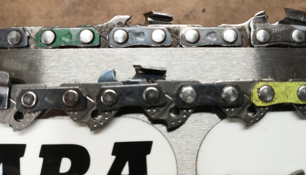

    They are essentially the same except the green has that added anti kick back nub that lies along side the depth gauge

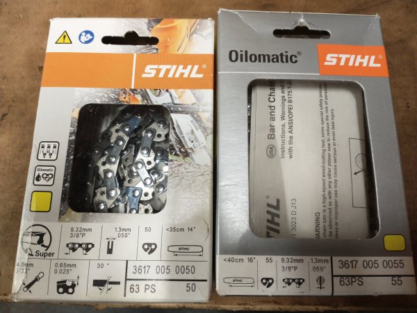

    I went out to the garage for ya bud...
    Green vs Yellow

    You should be able to take that picture to your dealer and say order me this in which ever size you need.

    interesting how that difference in raker shape reduces kickback.

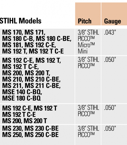

    From Stihl site.

    Interesting as it doesnt mention a 194 or 201? I dont think they have updated their site?

    I guess I didn't notice that. Some of the larger saws are missing too like the 462.

    If you look at the picture Brad posted you can see that the drive link also has a depth gauge "raker". It's purpose is to unfold and take up space between the cutters as the cutter goes over the radius of the nose there by preventing a quick solid bite.
    It has nothing to do with the tooth style.

    Thats where they get the reduced kickback from. Makes sense.
