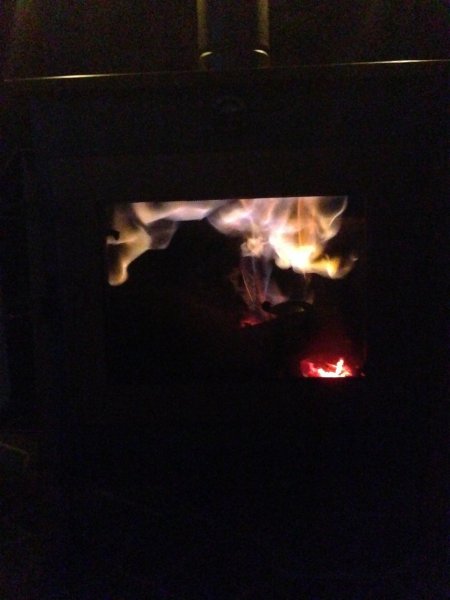

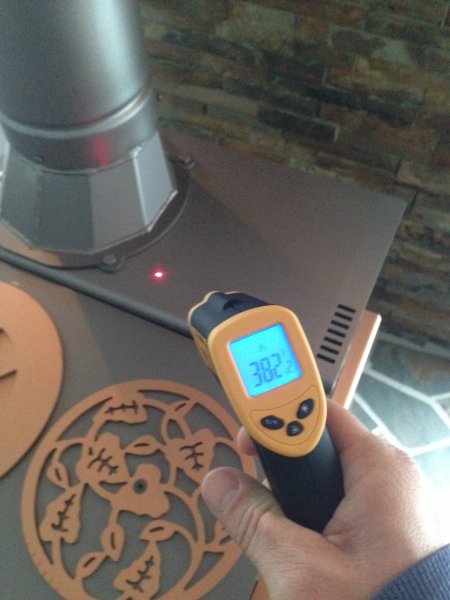

    Update..slowly bringing her up. No cat engagement. Headed to church in a couple hours, so will probably let this one die out.

  4. Brad38
    Brad38
    Jan 27, 2015
    575
    1,921
    S. Indiana

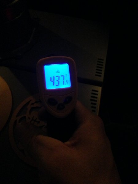

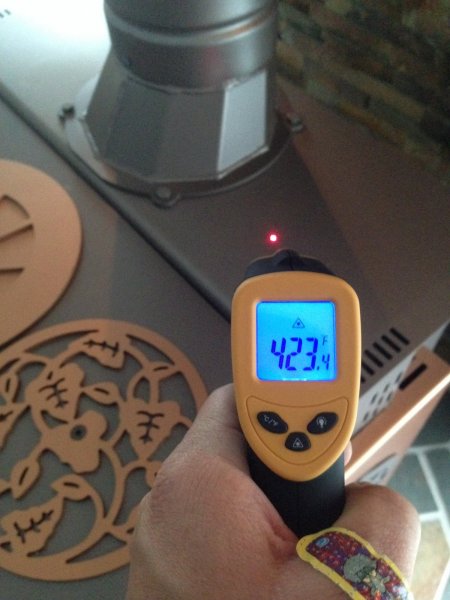

    Exhaust gasses (huh-huh) got to 500, so I engaged the cat. Dropped to 425 and a black box. How do I know the cat lit off?

    Here's the deal. The cat needs some time to react. Leave the air open. You can't just engage it and shut it down. I run the stove hot with the cat engaged for at least 10 minutes before I begin shutting it down in stages.
    Also, keep in mind that draft is not optimal this time of year. So the cat will need extra input air until it settles and cruises. Then slowly bring it down.
  9. Backwoods Savage
    49,081
    313,040
    Can't speak yet for sure on the IS but with the Fireview, many times the fire will go out but watch the stove top thermometer and it will go up quite fast. For sure then you know the cat is working. With our stove, we generally will turn the draft to about 3/4 of the way towards the 1 setting (setting from zero to 4) when engaging the cat. That's all we do until reload time. But if stovetop does not go up and flue temperature drops, cat didn't light. That doesn't happen often. And also realize that it is normal for the flue temperature to drop once the cat is lit so don't let that freak you out.

    That front thermometer you have there should start climbing fast when the cat is active. If that stays still or drops, toy know the cat stalled. You can also go outside and look for smoke.

    You can usually hear some clicking right above the cat when it takes off. I routinely shut the air down too quick and stall the cat this time of year.

    JA600 said just what I would have said. The front temp will climb dramatically and be much hotter than the top of the stove when the cat is lit. He's right that you will see some smoke initially from the chimney and once the cat lites, no more smoke. The cat engages at lower air settings also, too much air and the secondary burn tube consume a lot of the off gassing. If the stoves hot enough and you have enough dry fuel gassin off and you have the air cut back enough, the cat should engage pretty quickly.
    The more wood dry wood you have stuffed in that stove the easier that cat will ignite. Small fires when seasoning the stove would be more challenging for the cat to really get hot. The temps on the front of the stove versus the temps on the top of the stove will tell you what's going on with the cat.

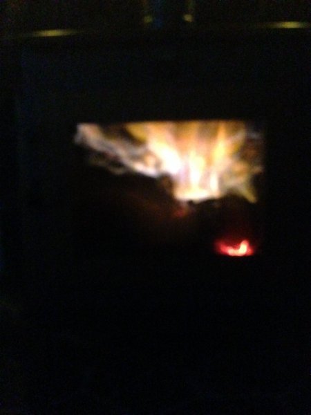

    Thanks for the help, friends! Guess I was just being impatient. Back from church, after running it low for several fires, and no more paint smell, I decided to load about half full with splits of oak and poplar. Using given advice and referring back to the manual, we have lift off! It's about 85 in the stove room, and 74 in the other. (55 outside though) I'm starting to sweat. Lol
    Love the light show!
    Glowing cat in top of dark firebox:
