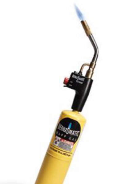

    Burnzomatic, Goss or TurboTorch. As long as it has a hose and doesn't screw right on the torch tank like this.
    If you want a leak, try this style torch...:zip: I can't even solder with one of those...:hair:

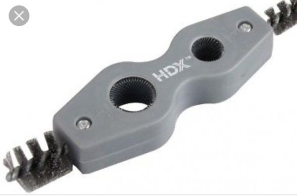

    You'll need a 1/2 and 3/4 inch wire fitting brush also.
    Looks like this

    Yup, mapp gas cyl works, but "the hose" Tim spoke of makes working in awkward positions SO MUCH easier! :yes:

    You can't turn a propane tank/torch upside down. And when you're in a tight spot, like against a wall, or plastic tub surround, you'll need to heat from behind the fitting so you dont burn the drywall or melt the tub wall...

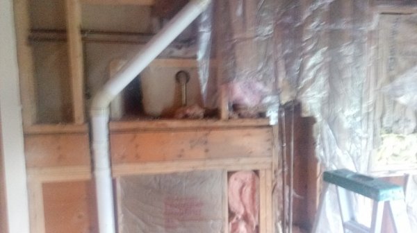

    Ill post a thread when done and can get to computer! But a quick pic
    Thanks for posting pics of good solder and flux.. My phone Dosent do that well.. Heck I got to clean screen now because of dirty fingers..

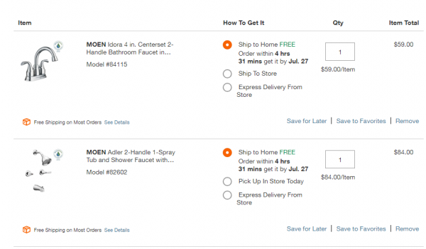

    Bumbling day here, one thing after another, lots of work and little progress deal, you know? :rolleyes:. Anyway, I give up on Lowes website. I found a great little vanity with a top for $59, great, the order finally went through :yes:, I wanted to keep it all at Lowe's so WWW didn't have to make two stops in Cheyenne (he'll be doing it on his lunch hour), but for the last few days I've tried to look there it takes forever to go from one page to another and often errors out. Actually I did have an order placed at Lowes the other night, then received an "order failure" email, sorry, we'll send you a $15 gift certificate in the mail. I've added a tub/shower fixture kit and bath sink and accessories 2 nights in a row, both nights my basket was emptied the next morning though it said 30 days. Ok, thanks, but looks like he'll be doing a pick up at Home Depot too. Same model for the shower a couple bucks less, different model on the sink also a couple bucks less.
    I'll have recreate my research on accessories but I'll do that at Home Depot. Within budget so far anyway:)

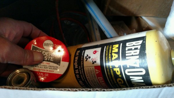

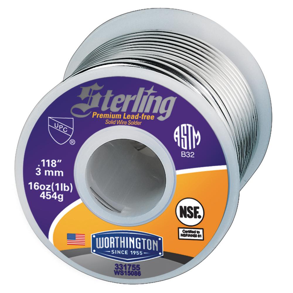

    I found the plumbing box, but couldn't get it down, I'll look later after WWW gets the box off the shelf. There is infact Bernzomatic, but I didn't see the torch (yet). Hey, guess what! Some of the disappearing plumbers putty cans and teflon tape rolls are are in there :rofl: :lol: Also a few new valves. Hopefully the brushes and pipe cutters are in there too. TurboDiesel , what makes that solder quality opposed to others? The flux can feels empty, its dinged up so I can't open it, ( I may or may not tend to use solder for many crafts/projects/rigging that have nothing to do with plumbing :emb: ) Eyeing this:

    First you want the solder to be "lead free" which is all you can buy now...
    BUT, the "silver bearing" solder has a lower melting point, quite similar to the old 50/50 lead solder, which was very easy to use since it would flow around the joint very easily and evenly. :yes:
    Look for Sterling, Worthington or Lennox.
    They all have the same purple label.

    Looks like there are other brands with the same contents. We only buy the Sterling.
    The boss told me a couple weeks ago he paid $1200 for a case...:bug:
