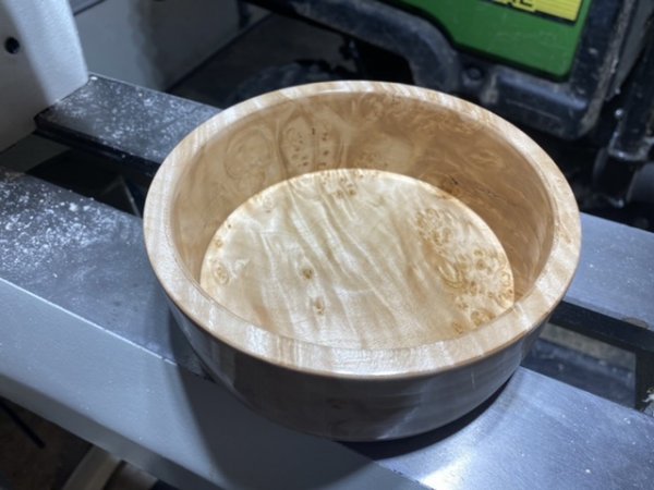

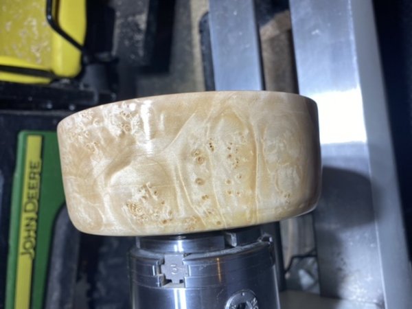

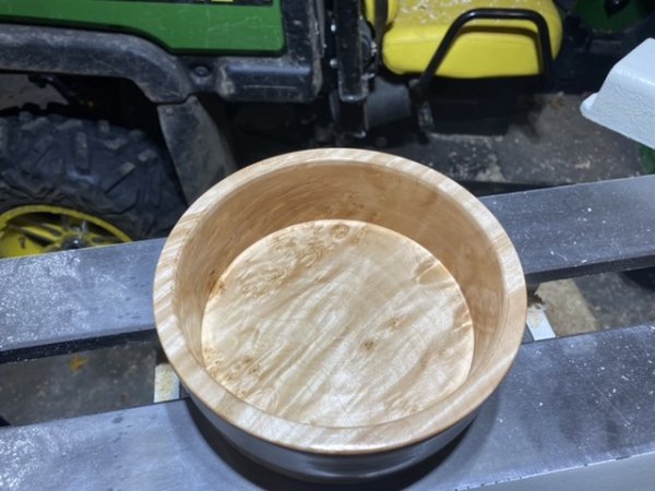

    I got my wood done very early this year and tried to avoid electronics. Tried some new wood hobbies though. 4E04FDE0-A6DA-4ADA-B3AA-9582A1B01DEE.jpeg 6AC9188E-AD07-4C4D-984B-92C2BEBCD445.jpeg AA4BB029-0437-4AA0-8581-73621423E93F.jpeg 1564750E-3496-4A7A-81D3-AB7A9AD322FF.jpeg

    Looks like Birdseye maple. Great job Woodsnwoods has done.
