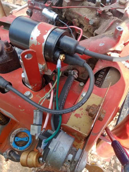

    QUOTE="Cold Trigger Finger, post: 1369544, member: 4825"]That's how I have it hooked up.
    I set the gap at 20 thousands . Cleaned the points contacts with a dollar bill.
    Still no spark at the plugs. :faint::hair:[/QUOTE]
    Do you have power into the+ of the coil. If yes do you have pulse out the - side?

  2. Screwloose
    Screwloose
    Jan 15, 2017
    5,697
    33,817
    Take off of the coil the wire going to the points. Take another wire and touch the negative post on the coil and with the other end tap a grounded surface. Every tap should make the coil spark. If it does then the point end is where the trouble is. Still no spark then verify +12v is at the positive post. A shorted condenser will also kill the spark so try it with that disconnected also.

    Do you have power into the+ of the coil. If yes do you have pulse out the - side?[/QUOTE]
    I don't know how to find that out without grabbin a wire with my fingers.
    I will see if I can get a reading with my AMM . If I can find it.

  9. brenndatomu
    25,320
    164,841
    You can test yourself, as mentioned above...if the points have continuity through them when closed, and not when they aren't, then they are working... likewise on the coil, if it has 12v to it, ground the other side, it should spark once every time you take the ground wire on n off. If you suspect the coil wire bad, substitute a piece of regular wire for the test...just don't hold it, the insulation is not good enough to hold back 50k volts if you have the gap to ground a lil too wide.
    And you can just leave the condenser off to test it...if everything works with it off, then put it back on and try it...the condenser only makes the points last longer, that's it.

  11. brenndatomu
    25,320
    164,841
    Correct, each plug fires, but it only matters on the cylinder that is at TDC (top dead center) with both valves closed...the spark on the other cylinder is just "wasted"/irrelevant...lots of small engines do this.
    So in the above picture, if you turn the key on, make sure the engine is at a point where the points are open, then take a piece of wire and hook one end to a ground point on the engine, and tap the other end to the - side of the coil (red wire)...each time you do this the plugs should spark...if they do then the points need attention of some sort. Wouldn't hurt to take the red wire off at the coil and then hook your AMM to the red wire to check continuity to ground...when you crank the engine over the meter should swing from infinity to low resistance to ground (continuity) as the points open n close.
    Make sure the wire is attached to the points correctly...if the insulator washer is put in the wrong spot, the wire will be grounded all the time, rather than just through the points while they are closed...I've seen this lil boo boo done more than once. Engine makes very little noise this way...usually more noises coming from the operator (mostly in the form of expletives!)
