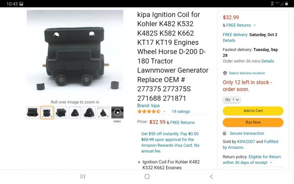

    Everything is the same as original just two individual coils. Screenshot_20210926-224312_Chrome.jpg
    I just looked at Google and these came up

    Mine takes the old-fashioned round coil.

    Coil shape means nothing as to the function.
