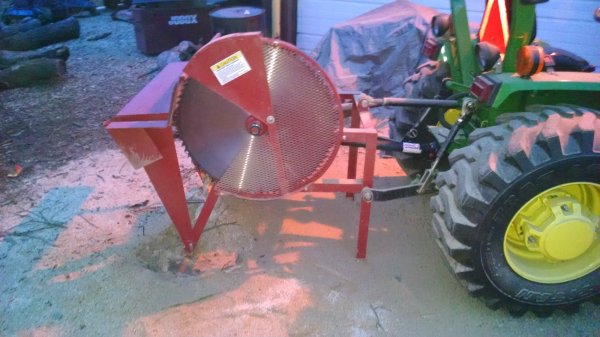

    The blade will definitely have runout when turned by hand. This is the tension that is put in the blade. The rim is stretched so that when up to speed it runs true. IMG_20151212_162721463.jpg
    This is one of mine and it has about .125" runout if not more. What is the model number of your briggs ?

    Thanks for the info. Interesting about the stretch on the rim. Not sure the exact model engine but it came one of these. TractorData.com Simplicity Sovereign 3416H 990871 tractor photos information
    I guess they do run up to 3600 RPM. I have a few of these garden tractors and they are pretty sturdy for what they are. That is a nice looking saw you have. Is that a new blade? I need to make a guard like you have there. The one I used when I was a kid was flat belt drive and not a guard on it. I can remember being very deliberate moving around that thing.

    Actually the complete saw isn't that old less than 10 years iirc. The thing is that the blade is always in the same place unlike a chainsaw. You have to go to it for an injury. And DON'T put ANY hook on the teeth as it then gets a mind of its own.
