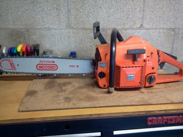

  17. HittinSteel
    HittinSteel
    827
    2,207
    Wooster, Ohio
    Obligatory pic or it didnt happen.
