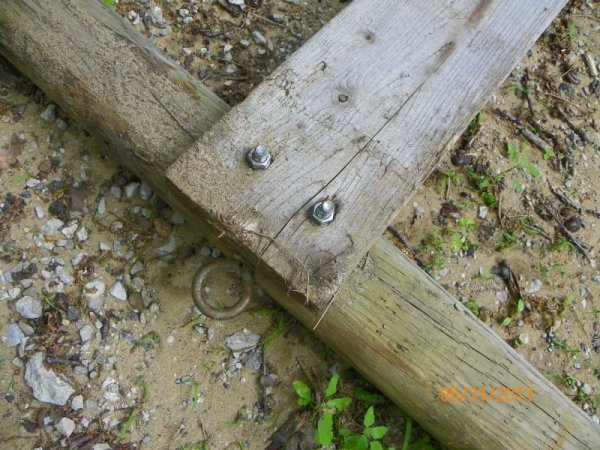

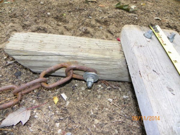

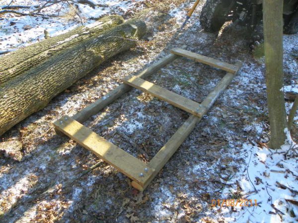

    Yes Dave, I rolled them with a cant hook and no ramp. This is what I had in mind when I threw this thing together. You will also notice the bolts sticking up. That was the plan as those bolts act as teeth when rolling the logs. If needed, a short ramp can be used and either nails with heads cut off or screws the same way or driven in from the back side will provide teeth on the ramp. This can be especially good when the snow is packy and the logs want to spin.
    Also you can see the eye bolts in the pictures and we just use a ratchet strap. One will hold a lot. Even when I worked in the woods, of course that was chain and binder but one was all that was needed.
    You'll also notice that I sort of pressed the issue a bit when fastening the pull chain on in that the hole is close to the bottom. So far, so good but I wanted it close to the bottom as it tends to give the dray just a slight lift to make the front a bit lighter and also puts a bit of weight on the rear of the atv.
    If needed, you could easily haul a 14' log on this 8' dray but to go longer would perhaps be pushing things a bit.
