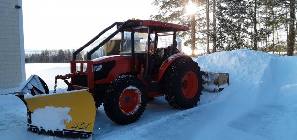

  4. Flamestead
    Flamestead
    Dec 7, 2013
    2,167
    10,970
    Windsor County, VT
    It is an M8560 (85 hp). We were shopping for a new M7060 this spring, but couldn’t get the dealer to take the time to sell us one because they were so busy. We switched to another dealer but then saw this on CL with only 250 hrs, being sold by a new widow. It is quite a step up from our 50 hp open station Kubota, and is a lot more tractor than I truly need. But it is awful nice!

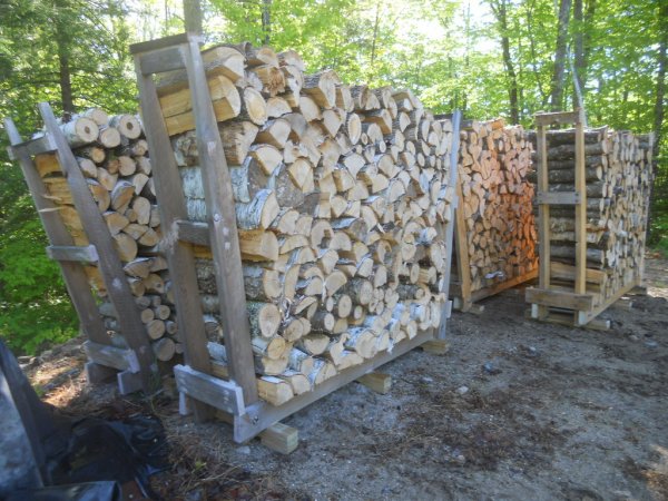

    I cut my wood 26" and my racks only hold 1 row of splits. I did make it much taller and they hold about 80 cu/ ft @ 26". I liked the way they fold flat and are the least amount of lumber involved seeing that I'm using them for drying and the resulting long term storage. I'm up to a dozen of these but would like to get to about 20.

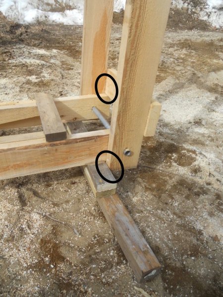

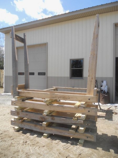

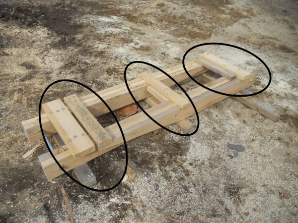

    I'm at the computer with a better selection of pictures now.
    I wanted single row for drying, so I went high. You can make them any size you (or your tractor) likes.
    Here are a few pointers that make folding them work that I found out. I repaired 2 of them today.
    In case you didn't see how they fold. I just used a 1" emt conduit for the hinge. A lot cheaper than black pipe.
    These 2 points keep the "arms" from falling out from the loaded wood.
    In this pic the top situation is a little short, I've made both of these circled contact points a little short on a few of mine (I usually make 2-3 at a time and really need a detailed drawing) have collapsed (open). The top circle is determined by the "hinge" location from the end of the bottom boards, and the bottom circle is determined by the "foot" location. They need to contact both points at the same time.
    I like them to open a little past center so that they stay there on a little slope. If they were 90* they like to self close, possibly on your head.
    I've also found that they need to be stacked off the ground on a block of some sort, we had some rain on about 20" of accumulated snows, that froze those suckers to the ground to where even being gentile, I split one of the bottom rails. Having a block (I cut up some of those junk "landscape ties" that are treated and about 4" thick. They separated nicely from them last year even though the block was frozen to our planet.:whistle:
    ^^ You'll notice that the placement of these cross ties need to miss each other when it's closed. There's not a 2nd one in this pic, but I usually have one at the middle point on both verticals.
    For reference, I used 2x6 (full rough sawn) for the bottom rails and uprights. That taper on the uprights is because I'm a cheap bastard and that cheats me about 3 extra feet cutting that long angle on a 10' board yeilding me 2 6' uprights. These racks are about 44 sq/ft filled to the top, multiply that by your length and you'll have the cubic ft. At my 26" they hold about 90/95 cu/ft. I ONLY use good exterior screws to assemble these. Nails in this application will loosen in no time with all the jiggling around moving it loaded with a tractor.

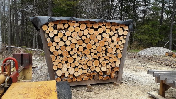

  20. fuelrod
    fuelrod
    Oct 4, 2014
    3,508
    20,523
    Western Maine
    I have a limited attention span:D
    This pic may actually answer your question:rofl: :lol:
