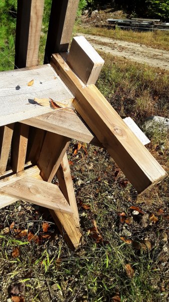

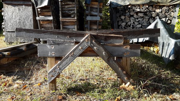

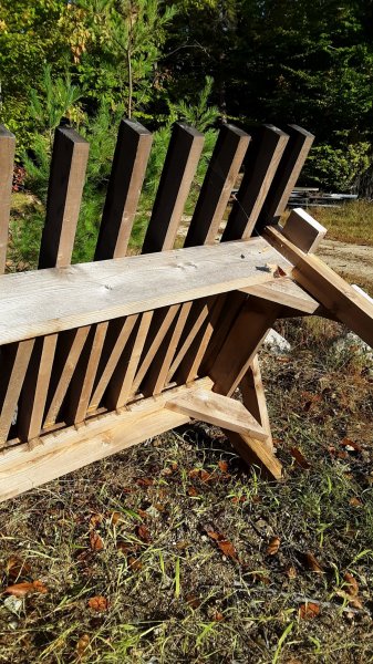

    Iirc it was like 98 8' 2x4's, 2 2x8x (legnth) and some "legs". I happened to have enough 4x4 pt around so I used that.
    It's not rocket science but I'd be happy to take some more pictures or measurements.

    I used 8" for my spacing, making your "layout" on your long sills 4" (to keep everything parallel) and simply cut 8' 2x4's in half for the top. The little pitch was to avoid having a wrestling match with a log that wants to get away. I'm satisfied with the design and really wouldn't change anything. I like to use screws for this kind of thing that see's repetitive loading, shaking and general jerking around, those things tend to work on a nails holding power. I also put them in from the bottom knowing that the saw chain will be apt to be nearby.

    Thank you Fuelrod! I am considering building something similar on a hay wagon frame. Just trying to get ideas.:)

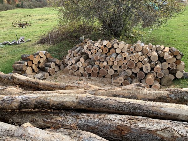

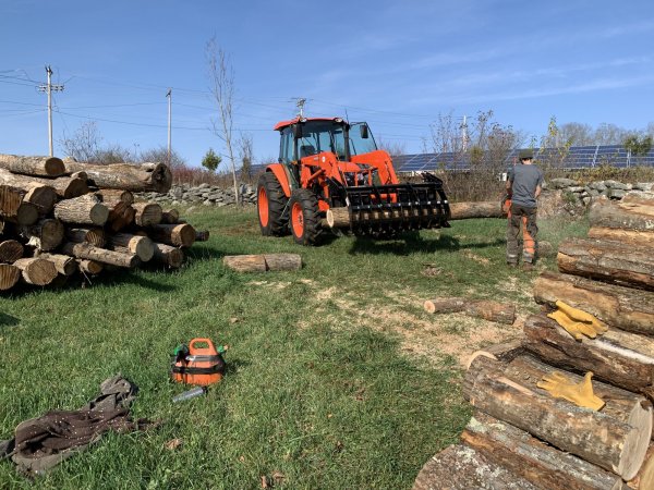

    I had been nibbling at the pile and was maybe 4 or 5 cords into it. A friend I hire to save my back came by today and banged out the rest. Ahhh, to be young again! Just one saw running, bringing logs over one or two at a time from the pile.

    I was thinking of doing something similar. How many logs do you load on there at one time?

    Depending on the size, too many and they just in your way. I load from one side with the tractor, cut them to length (from each side) then get on the side of the splitter and pick them up (at waist height), turn around and put the round on the splitter. I make an imaginary triangle, splitter, log table and movable rack for the finished split wood. I move these racks away and it dries in them for at least a year, then move the rack to the house. This cuts back the times I handle the wood to 2 times once it's split and on the rack .

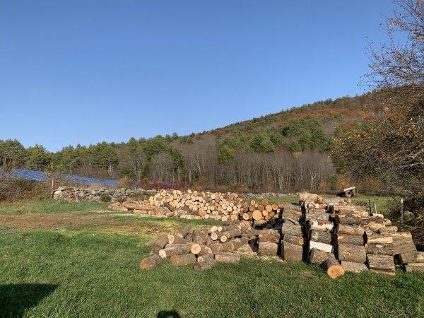

  20. Flamestead
    Flamestead
    Dec 7, 2013
    2,167
    10,974
    Windsor County, VT
    I hope to get at least half of it split and stacked before the snow gets deep. These overcast nights sure get dark fast, and the coming time change will fully stop my evening work window.
