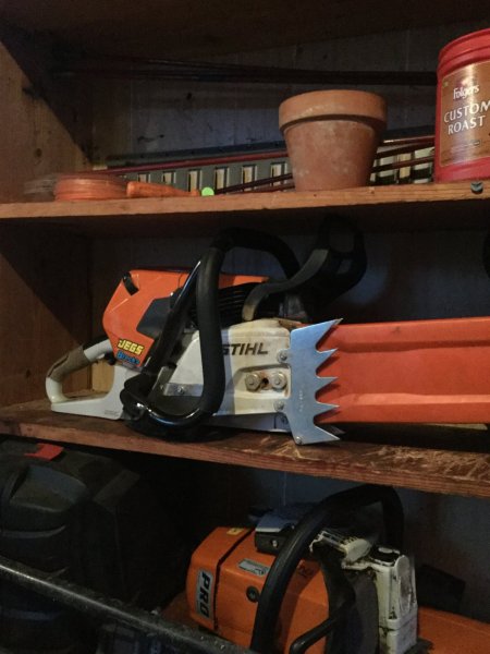

    thanks it will look better very soon i got a full wrap handle coming in the mail and i will be doing more work to the clutch cover more pictures to come soon!

    member: 3"]Wow.. Look's great!! Nice setup![/QUOTE]
    image.jpeg Here she is with her 3/4 wrap. Man I can only say good things about the 3/4 wraps it's like you are using half the saw without it.
