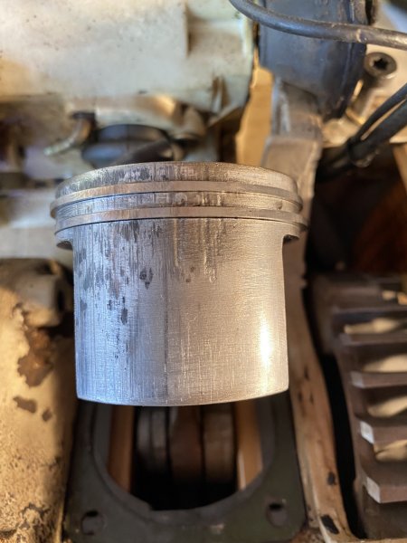

    My brother is helping a friend clean out a building. I went by the other day and came across this. It was a tree service saw. Handle is bent and piston looks rough. Looking for opinions If this is worth fixing. I’ll attach pic of cylinder as well.

    I am by no means a chainsaw expert mechanic (i'm better at running them) So the question is how do I know if the cylinder is still good or not?

    Rule of thumb is any scoring into plating that catches a fingernail is unlikely to be saved. If it's metal transfer and a layer on top of cylinder plating then it can be saved with fine grit scotch brite or muriatic acid. You can Google both techniques, I like the prior.

    Agreed ^^. Be very very careful with acid. If there is any minute flaw in plating, it’ll get behind it and eat cylinder material. If you need it, there’s a great YouTube tutorial on cleaning up those cylinders with transfer.
