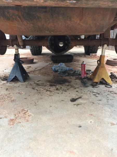

    image.jpeg image.jpeg Lol clemsonfor rear 12 bolt. And his front Dana 44 we will be rebuilding at a later date. Probably the only maintenance this thing has ever seen :picard:

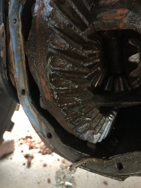

    Man that thing is nasty. I do not think I have ever seen a ring and pinion that bad before.

    Mine is a rear 12bolt I am working on. I haven't opened the diff, but I hope mine doesn't look like that inside:eek:o_O.

    I have a few broken ones under my belt but this one takes the cake! Pinion bearings crapped out damaging the carrier and breaking almost half the ring gear teeth.

    Oh, looks like fun, boy!! that sucker is chewed up

    Might be better to go to the junkyard and get a whole new rear end

    i had similar thoughts but he wanted to keep what he had... I have a 3/4 ton semi float gm axle with 1/2 ton wheel pattern sitting here. The rear axle is salvageable. The front with busted gears is not however.
