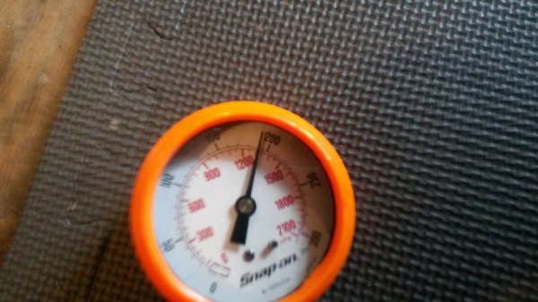

    Nice. My 026 project had that exact same compression. Impressive little buggers, aren't they?

    I wish you didn't tell me which was which on the octane vids! Never knew of 94, I only see 93 here.
    Dumb question, but how important is the ground connection on the tach? I ask because I got the same reading open and grounded.
