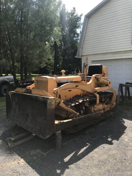

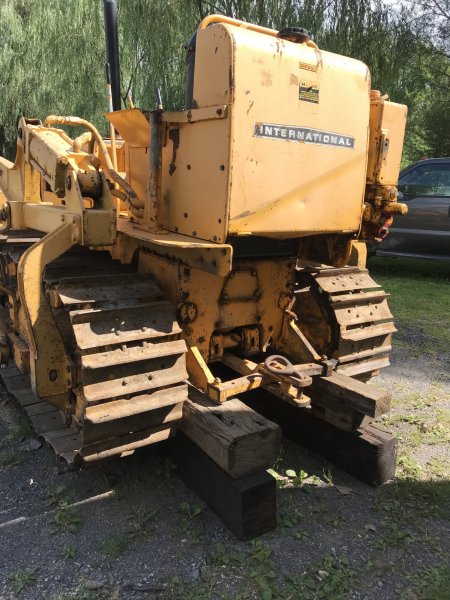

    Been busy with the house and work so haven’t had much wrench time. I did manage some stack paint and to get him up on blocks so I can pull the clutches. B13BE354-02A5-4515-B5B6-2A9C85C6CD43.jpeg C92CF861-31CF-4D45-BB4E-A91463E2AA31.jpeg 80D82E67-E227-4C87-B341-C5EBA4A964F7.jpeg I also found a local parts place that I can get oem parts so I picked up a fuel cap and some other covers I was missing.

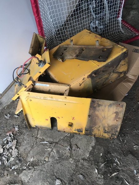

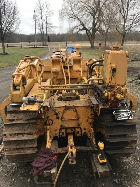

    Time for some fun!!! Had an hour or so after lunch today and started in on the progress. Tank off and surrounding supports and sheet metal for the operator platform. I’m going to blast things out with the pressure washer before I continue since I unearthed more oily goodness!
    0F12E80D-1EC4-435F-A07B-C56DCD49F58D.jpeg AE43637E-C13B-4AAD-9941-4790F0E8AABC.jpeg 4C8F6428-4084-4A2A-BA8D-E4B6B84A923A.jpeg
    After I clean some I’ve got to remove some of the plumbing and then the heavy “fender” pieces that go over the tracks so I can remove the cover to access the clutches.
