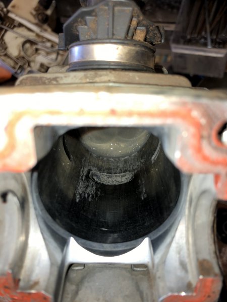

    I’m still wondering how the bar oil leaked out? Did it melt the cases?

    271/291 are the same saw different bore. No aftermarket cylinders available. I’m guessing the seals are good since it’s a newer model. Either it had old gas in it or it was tuned too lean and finally gave up the ghost when the weather cooled down

    Do I need to remove the clutch and sprocket to get the cylinder to separate from the crankcase anyone?

    Not a mechanic but if the piston is seized solid at top of stroke that would cause problems I imagine. Does it move?

    Yeah, thats what I thought. Did all that. Got the four bolts removed but it’s not coming apart. I’ll have to take another run at it after I get some time after Christmas. I hope it didn’t do something horrible like weld together…

    I had a bar sprocket get jammed with junk and my saw acted like that. Saw got hot then also.
  15. Horkn
    29,264
    167,083
    I had that happen too, but did you see his piston pics through the exhaust port? Mine was literally just a bar tip sprocket jam as well as yours. This one is a bit more drastic.

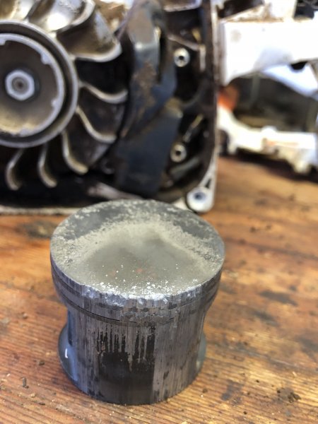

    You need to pull the crank out because you will most likely replace the piston. Also, you can replace the cranks seals at the same time.
    Taking it, all apart will make it much easier to clean up. Make sure you use sealant that is fuel proof like yamabond.

    Finally got it apart. Piston and/or rings had a firm grip on the cylinder wall but got it off. Lookin pretty bad. Can the cylinder be saved?
