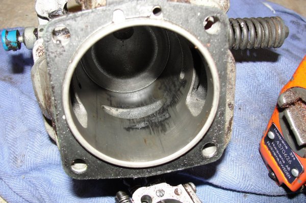

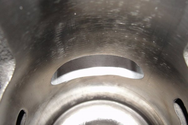

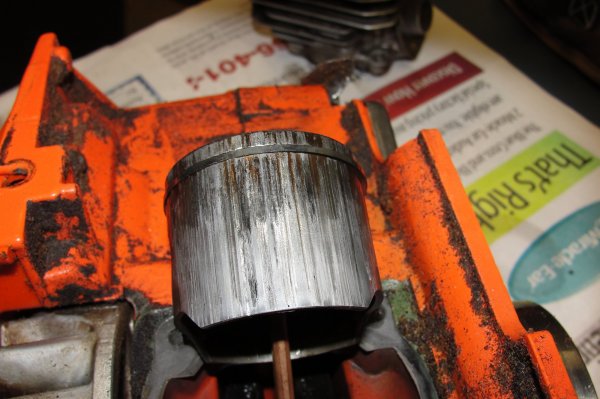

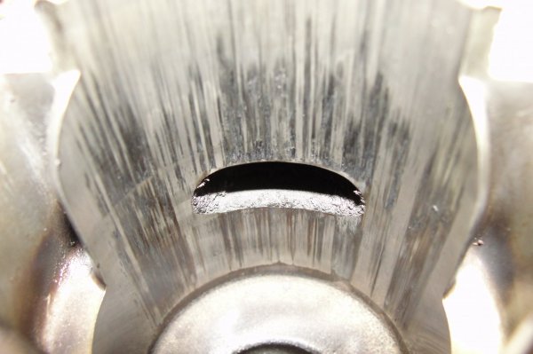

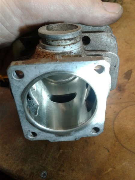

  15. The Wood Wolverine
    18,994
    122,663
    Is there a chance you could remove it and post some pics? If it looks horrible, with deep scratches, it's probably not worth trying. If the aluminum is somewhat smooth, probably is.
    Like this is pretty much trash:
    This is easily cleaned up:
    Sometimes you won't know till you remove some of that piston material. Then deep scratches show up, like this:
    The cylinder wall plating is very tough stuff. It can withstand a lot of sanding.
    Horkn, WinonaRail, Cash Larue and 4 others like this.
